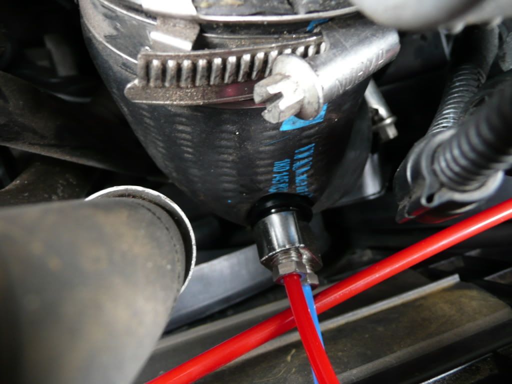

Where the nitrous and fuel is injected into the inlet, just before the intake manifold.

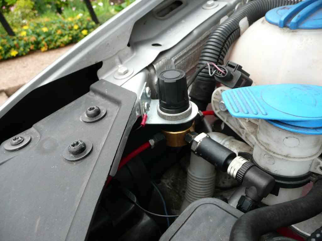

Fuel regulator mounting position

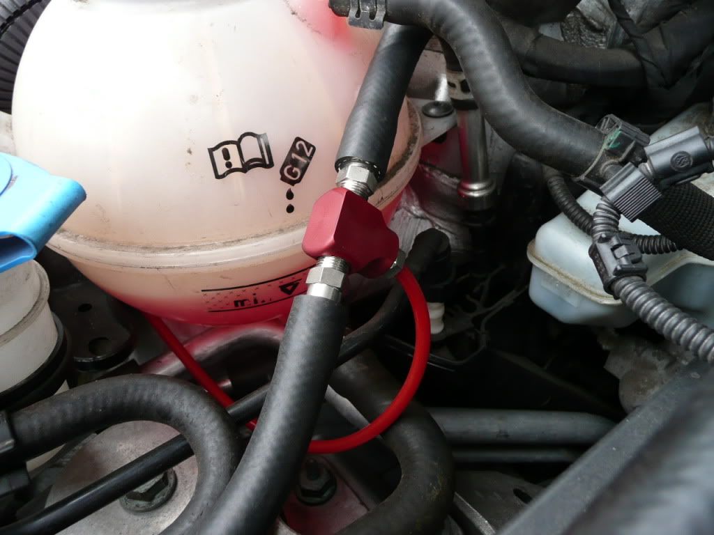

How/where the fuel is tapped into for the nitrous system

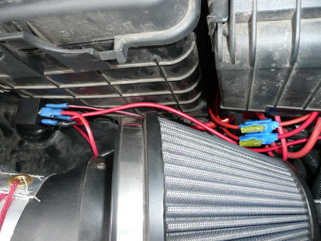

Electrical tap into the injection system for rev timing
