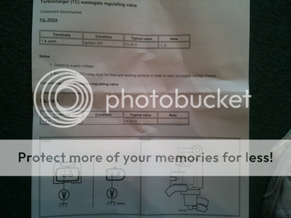

recieved these two printouts from my mates garage to explain the limp mode i keep getting. anyone know how to fix this problem?

anyone got any ideas? if it happend to them.

either a boost leak or sticky turbo vanes
have a good poke around your boost pipes

thanks, i used the turbo cleaner couple weeks bk which i hoped wud sort it but it hasnt. ill get my mate to have a poke around, would a leak be easy to spot?

Look for any signs of oily film - that's normally a good indication.  Also check the condition of the o-rings, clips and lugs.  The clips snap, the lugs wear under movement and the o-rings can perish

ok cheers. if it was the vanes or a leak would limp mode come on more often? as its only realy happening on long journey after about 100 miles doing about 80-85mph then wen i put my foot down to overtake it starts to boost then shuts down into limp mode. think its happend 4 times in the last 3-4 months.

that sounds like sticky vanes to me  :sad:
Although Steve had a similar problem but I think his was down to a loose fitting boost pipe  :undecided:  It only came loose under high load i.e 5th / 6th gear and at those sorts of speeds.  Think the lugs were completely worn away
