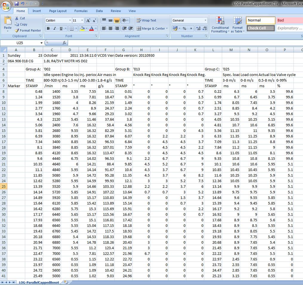

Capped the boost in parallel today and logged.  Only got once as its now started to tap when running from the back of the engine.  Not sure what it is yet as its too hot back there, but hopefully its something silly and not valve related/internals.  no smoke or oil and even boosts fine and no dodgy idle or missing.
Probably popped the manifold/head gasket which was only put on couple weeks ago.
Anyhow, less of the boring stuff...heres the log i got.

Sounds a lot like a sticky lifter in all fairness.  Nothing at all to do with mapping or anything like that, in any way.  Engine flush will go through tomorrow and see what happens.  Worst case scenario is the lifters get replaced.

It sounds like a lifter to me, not much else it can be. If you need on left me know I have a few sets knocking around.
And the run above it seem like the car jumped in to limp mode at 4600rpm, due to under load.

What would cause it to drop into limp mode?

the knock regulator reading on cylinder 4 at a guess?
Any codes?
