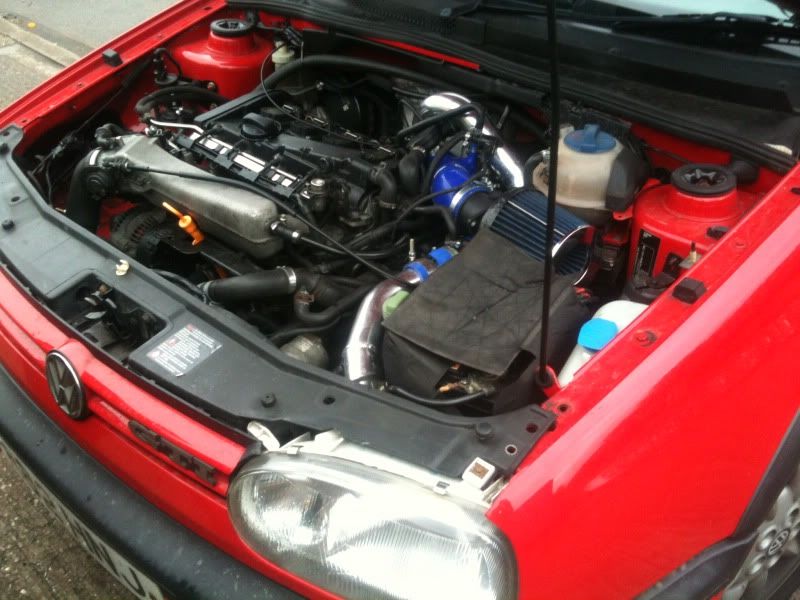

Nice little mk3 with an engine conversion, running an AGU with uprated CR Turbo Ko3s 224bhp 225lbft after a 2 hour mapping session today, more to come.   Its running a LSD with some kind of Audi 5 speed gear box with some awesome gear ratios, it gives the car a feeling of a big turbo power in 1st gear, no power until 4200rpm, but the power at 7000rpm feels like the power should be at 4000rpm... You know what I mean.

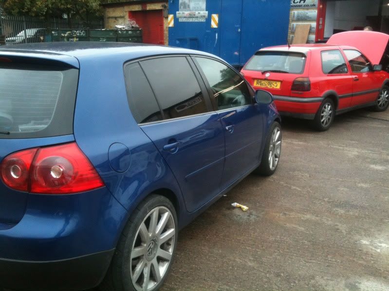

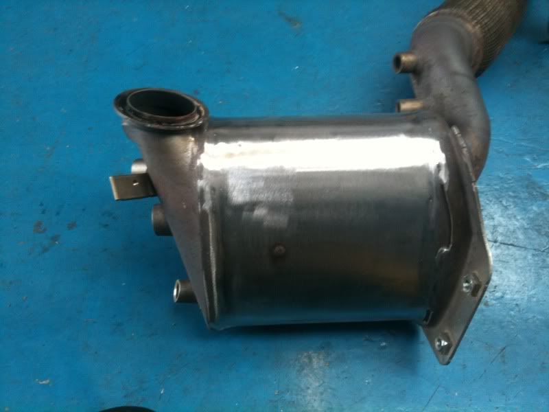

Yet another Seat Leon 170 stuck in DPF regen mode.... :grin: Booked in for a DPF hardware removal, virgin state ecu mapping then a custom remap if all is ok.

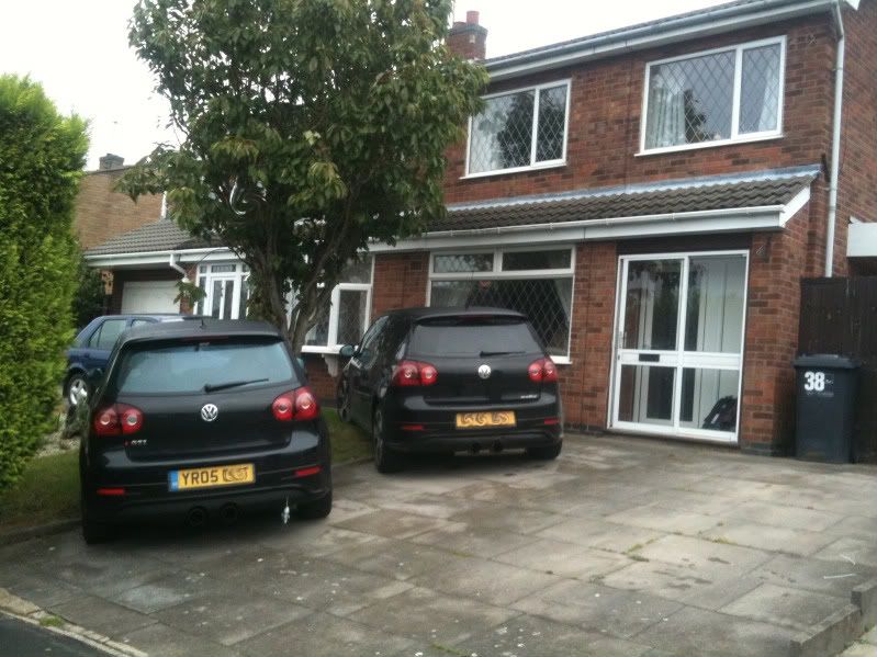

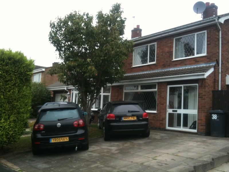

My drive way for the back log of work, one mk5 gti goes home and Audi 4wd 2.0TFSI fills the slot.

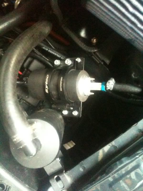

My longest custom remap in history (Yohan) VW Bora with 4 motion running gear and S3 AMK Ko4 engine setup , I already had car for over a month now.. :embarassed:  but keep running into issues.  New high flow fuel pump fitted to improve poor spary pattern and to get the actual lambda to match the requested values.  From the seat of my pants testing I can tell straight away the pump has made a huge difference to the performance... maybe we can run it at 24psi and make 275+bhp at the top end without any major pre ignition issues.
