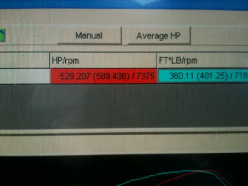

When we first had this car in 2 years back it was kicking out around 300bhp limited by hardware issues, related to fuel flow and ignition coils.  A few live dyno/road mapping session ealry on this year gained around 340bhp, then over the last few weeks tuned to 440bhp limited again by fuel flow (crap complex nissan design)  So the 044 motorsport fuel pump was fitted.
Todays live mapping session (after spark plug issues) managed a peak power of 440bhp @1.3bar as a starting block, After many steady state live mapping sessions we worked our way upto 577bhp timing around 21deg and 1.6bar boost.. :wink:
 But not the right day to do the road test... had enough of watching my 6 year old son drifting/spining his Bambino race kart this morning and planted it in the tyre wall at 30mph, so dont fancy seeing 577bhp leave the road.
This is one of the 10 cars we are taking santa pod next week weekend.. :wink:  Along with a 520bhp Astra Gte, Kadet 490bhp 11.4s 134mph, mk4 1.8T 410bhp, Mk1 1.8T 320bhp, my golf 370+bhp :smug:
First runs 440bhp
Runs between live mapping sessions
Videos
Close up of a tyre on a dyno at around 506bhp on this run.
Final power run 577bhp 1.6bar boost with 8000rpm
(to be uploaded off another phone)
In the end this car only made it to the gates of santa pod last week, due to eating spark plugs and having major missfire under load after arounf 30 miles on each set of plugs, which has now been fixed by fitting a new ignition amp which gave a slight improvment in midrange power.  We thought as we had a stronger spark we could get a little more power from the beast, so a sunday morning remapping session was needed today.... the results close on 590bhp.. :laugh:  Its set at 590bhp to do a few weeks road testing, once all is well I think the aim will be 2bar boost and 620+bhp ready for santa pod end of year shows.

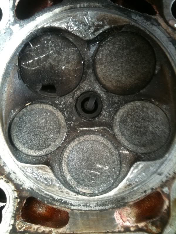

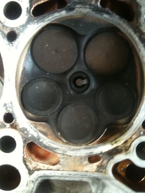

The result of my water meth failing, and the reason for the puff of smoke over the line in my last run..  :grin:
Cylinder 3 melted piston crown and exhuast valve been consumed as fuel..lol
IMO it would not of happened if the water had been cooling the cylinders as it should have been and the car was mapped for zero timing pull using detcan with WMI on., the reason all the other cylinders are 100% spot on and number 3 dead, it that number 3 is the closest cylinder to the turbo and has the shortest manifold running to the turbo. A  cylinder honnned out and another piston and valve to go in Tuesday, then fab an EGT sensor probe on number 3 runner of the manifold to montior whats going on.  I think I can say I know where the limit is of the stock AUM k03s manifold...lol  I am going for one more run at pod with the R-Tech K04001-023 hybrid turbo, the low comp pistons, 700cc+ injectors with twin scroll GT35R and one of a few in the uk running a Performance Quick Spool Valve .. :laugh: http://www.youtube.com/watch?v=I6ZCOTFET6s&feature=related
