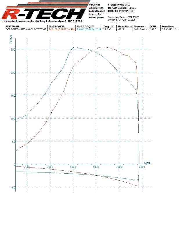

R-Tech Spec1 custom remap S3 K04-023 270bhp with TIP
Golf Mk3 1.8T Audi S3 AMK engine k04-023[/b] R-Tech Custom Remap session-v1 270bhp 275lbft MAF flow 219gs @ 1.2bar

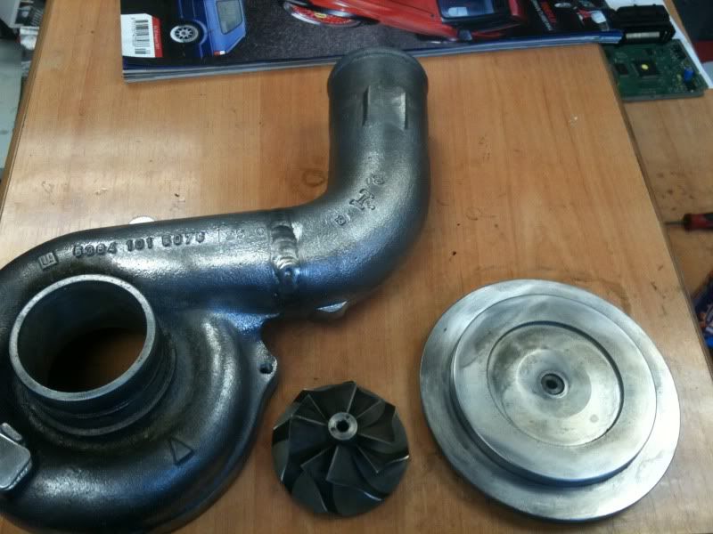

Stock mapped 2005 Audi A3 2.0TDI 140pd with 88k which has had sticky VNT for 3 months and only went into limp mode 5 times.
End result was melted turbine wheel tips and melted VNT vanes which has resulted in the turbo being a door stop.
If your running a TDI 1.9TDI or 2.0Tdi no matter what year then get your VNT checked. The turbo can over boost to 40psi and hold 35psi without you knowing, the only time the car will show a fault code is when the ecu sees 400mb of over boost of 10seconds or more in one stint which is when the ecu cut the fuel, BUT the car will still be over boosting.
We are now doing around 7 VNT turbo repairs each week, I would say 5 out of 10 TDis
 with over 60k will suffer from sticky VNT and will have 17965 - Charge Pressure Control: Positive Deviation
We have opened a new two workshop bays just for VNT cleaning and DPF issues cleaning and removal

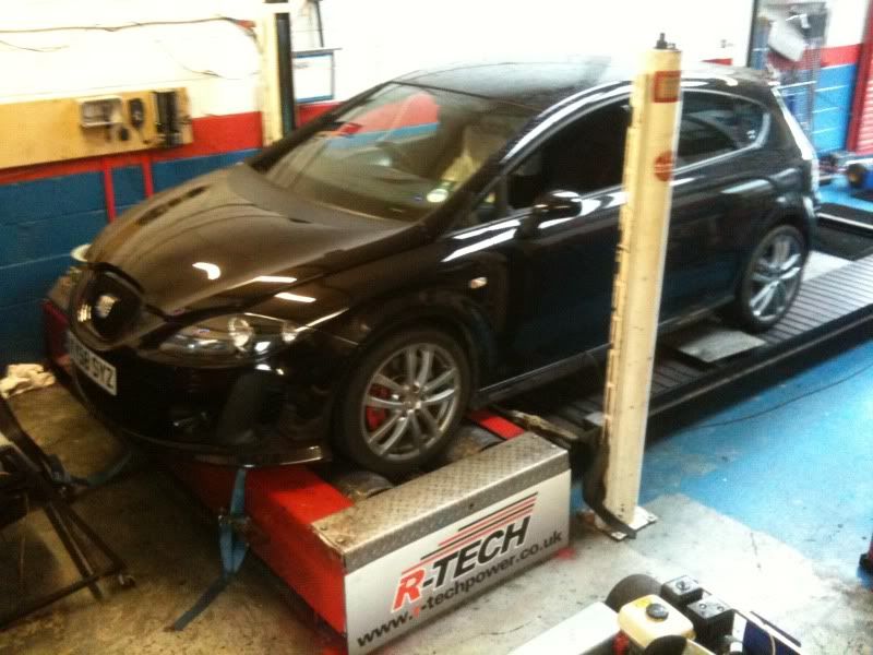

Saturday 16th July 1st job Seat Leon K1 K04 2.0TFSI 240PS
Before and after power runs back to back
Seat Leon K1 R-Tech custom spec1 rolling road remap session

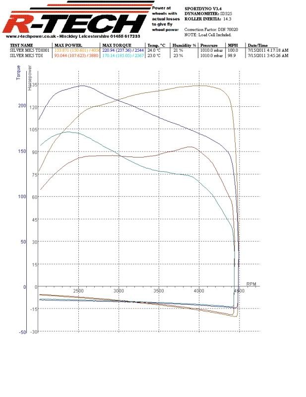

Rolling Road remap session 2007 Mk5 1.9TDI 105bhp stock and r-tech spec1-custom map

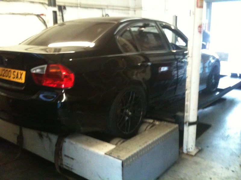

Another Brand where we excell derv BMW tuning

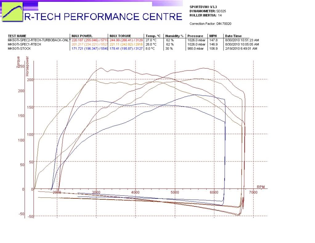

Mk5 GTI 2.0tfsi rolling road graphs back to back
Stock
R-Tech Spec1
R-tech Spec2 with induction kit and turbo back Performance exhaust, very quick and strong across the whole rpm

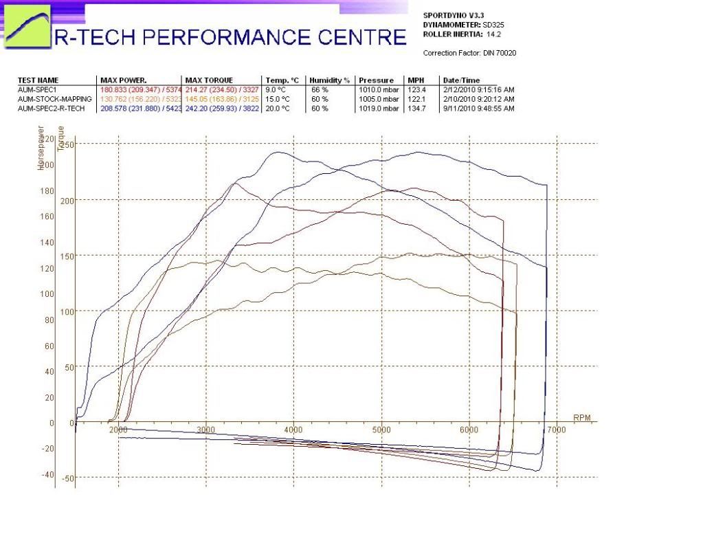

Golf AUM 1.8T 20v ko3s (not same car on all 3 runs)
Stock Mapping  = Stock filter & oem DV - 95 fuel = 156bhp/163lbft
R-Tech Spec1 =  007p with yellow spring - Pipercross filter - V-power = 209bhp/234lbft
R-Tech Spec2 =  007p with yellow spring -Cold air induction kit - TIP- THS front mount intercooler - Milltek Turbo Back = 231bhp/259lbft
Spec2 mapping allowing for extra mid range boost without running the risk of too much heat build up, 21psi peak and 18psi held with VE tail off, which gives close on to 100lbft gain from stock in the midrange and holds  on to it really well, without too much heat build or fuel dumping.

How come there is less transmission loss on a AUM than a AGU?
AUM spec2 231 bhp @ Fly - 208 @ Wheels

« Reply #2 on: 10 August 2010, 16:16 »
AGU KO3s  231bhp @ Fly - 200 @ Wheels
There is not one fixed rate for drive train losses, wheel weight, wheel size, tyres, brake discs, bearings & temps, gear box fluids, diff and transmission condition, strapping down on to the rolling road ect..  Some rolling road like the dyno dynamics just add a fixed % to the wheel power, which is give a false reading for the engine power because there dyno cannot see the drag factors during the run.  I can get the same result for the flywheel power even if I apply the brakes during the whole dyno run and the coast down.

Would it be strange though if myself and a fellow AGU K03s user both produce 231bhp and both get 200 at wheel? Both on 18 inch wheels
One car could push 200whp and 230fwhp and the other 197bhp and another 230whp or even 205whp and 230fwhp
More drag = less wheel power on a Dyno Dynamics rolling road you will get a low fly wheel power full stop. On our rolling road we can work out the exact drag during the run which is added to the whp as a factor not a estimate or calculated %.   Rule of thumb is 15% for fwd transmission losses so 200whp works out around 230 hp at the fly and 22% for a rear wheel drive car which work out about right for the C20let Kadet we ran at 330whp & 399 hp at the fly.
Two brand new cars just out of the factory should give the exact same whp losses and fly hp, but if you change  one cars tyres, fill them with less air and use thicker gear box oil ect the drag will differ so the power at the tyre contact will differ but with the losses added (from the coat down run) the flywheel power will be about the same.
I can run a car will cold tyres, cold gear box and diff, cold transmission fluid, cold bearing ect and get lets say 250bhp at the fly, then run the same car with hot gear box, tyres bearing ect... and still get 250bhp. BUT the output would look like this:
Cold run = 220 wheel hp with 30bhp drag losses = 250bhp at the fly
Hot Run = 223 wheel hp with 27bhp drag losses = 250bhp at the fly
