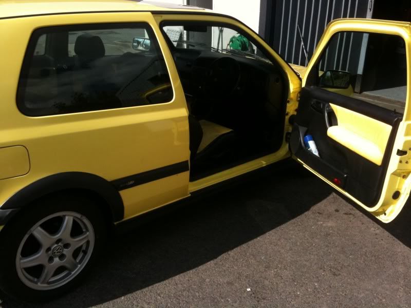

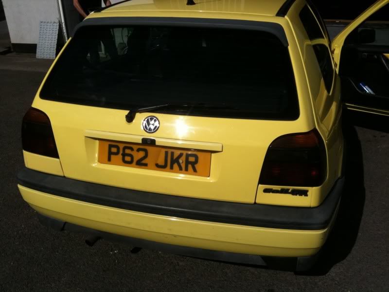

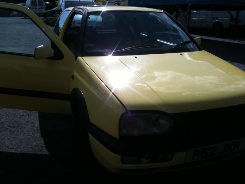

Heres a few terrible photos of the car before I really did anything to it, just a quick rinse.
Front grill/valance removed as it in very bad condition, photos in a future post
This side of the cars in pretty good condition, few rust bubbles on the lower part, which im getting sorted when the left side is resprayed.
Panel behind the Golf badge is dented in, getting sorted along with the paint. Have some new plates which i'll put on when its time.

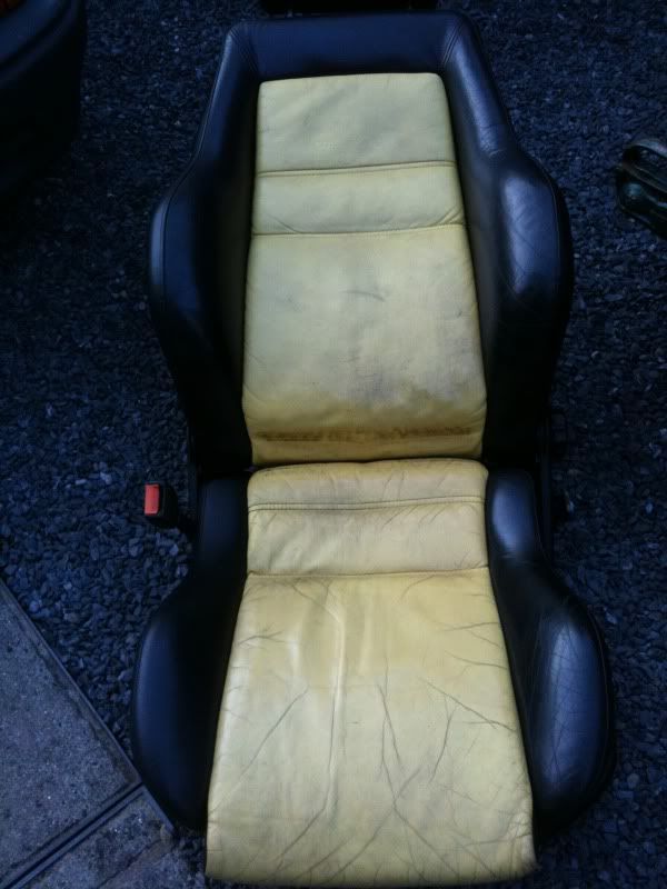

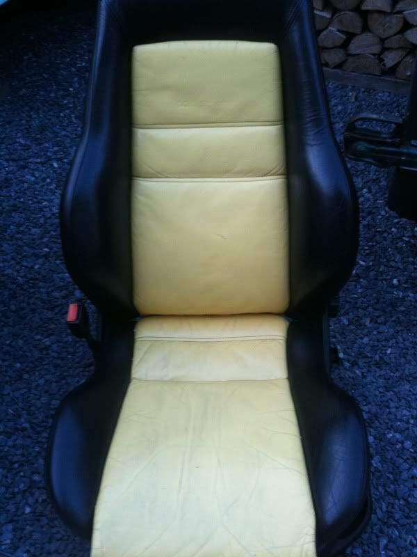

I removed all the seats except the drivers seat to clean up.
The seats are filthy, but in excellent condition considering the cars age.
Here is a little before and after of the passengers seat. I used warm soapy water, followed by Auto Glym leather cleaner and Auto Glym leather balm.
All other seats came up just as well, but 2 photos are enough!

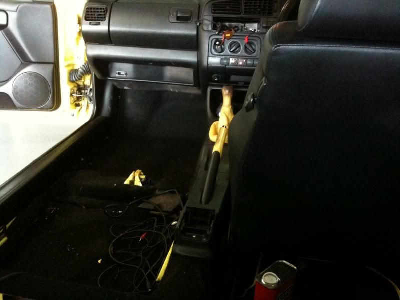

While the seats are out I decided to give the carpet (and under the carpet) a good hover and remove the mini disc player (lol) and CD changer. I may run some speaker cable while they are out if I get hold of some in time.

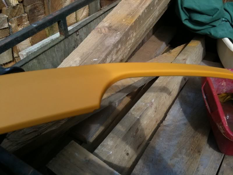

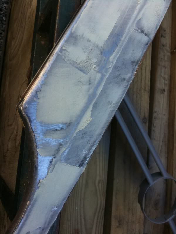

Right, I was going to just buy a new grill but all I could find on eBay were debadged ones, so I decided to try cleaning it up.
Firstly I tried taking a heat gun to it, but after about 5 mins the gun broke, and hardly anything was achieved.
So I just decided to take an angle grinder to it, and it worked a treat.
I should have used a finer sanding disk, but the damage was done, so I needed a lot of filler.
After some sanding and priming, its all ready for spraying. Plastic parts were very easy to prep
« Last Edit: 16 June 2010, 22:44 by Chew22 »

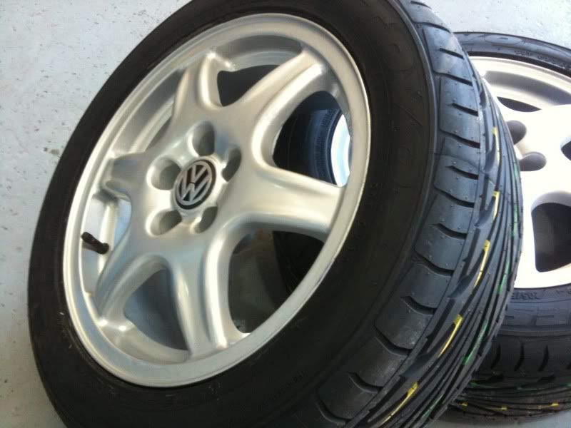

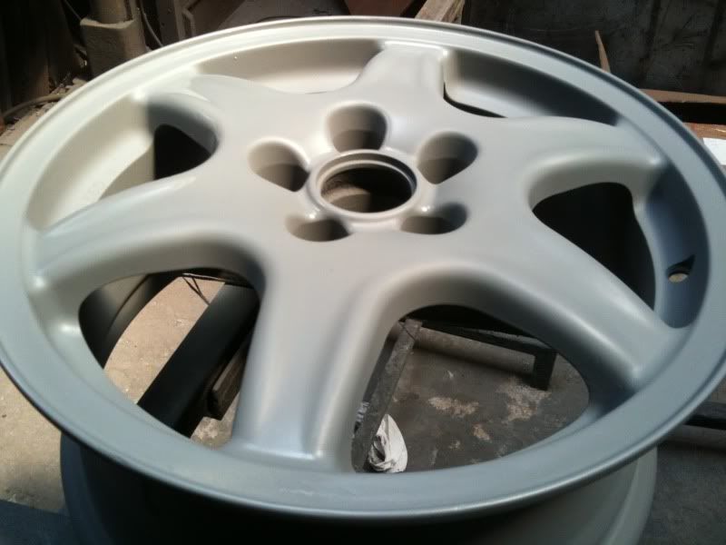

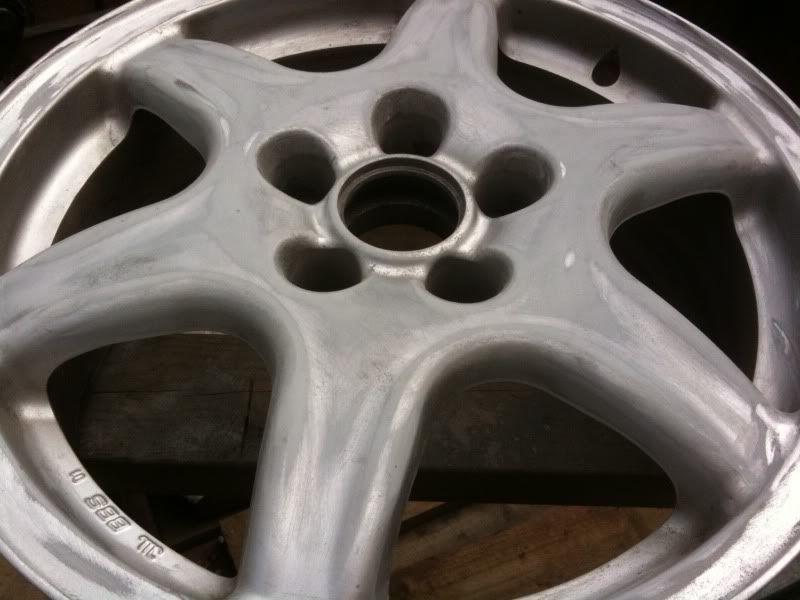

Alloys were in surprisingly good condition, with just some corrosion where the weights were and slight curbing.
All prepped ready for priming.
Optimus Primed
Finished wheel with new Toyo tyres fitted.
Brought some good quality rubber centre cap stickers to bring them back to life.
EDIT: They seem to be not so 'good quality' as they are coming loose already, will try something a bit more industrial to hold them on asap.

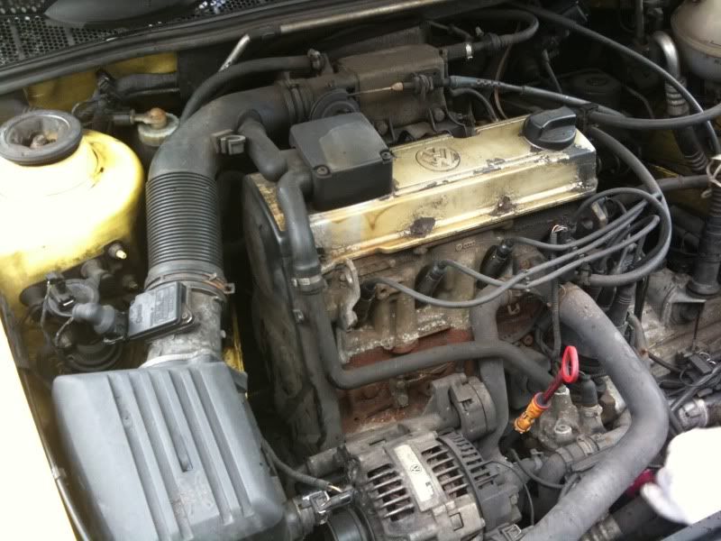

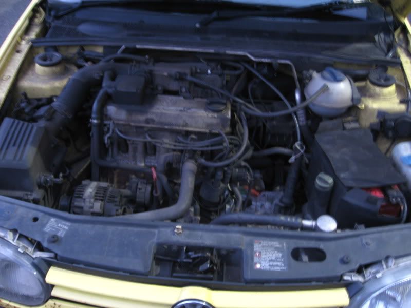

Photos of the engine bay before degreasing. Totally forgot to take any 'after' photos, but will soon
