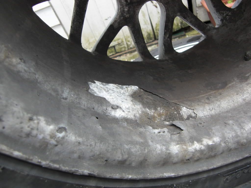

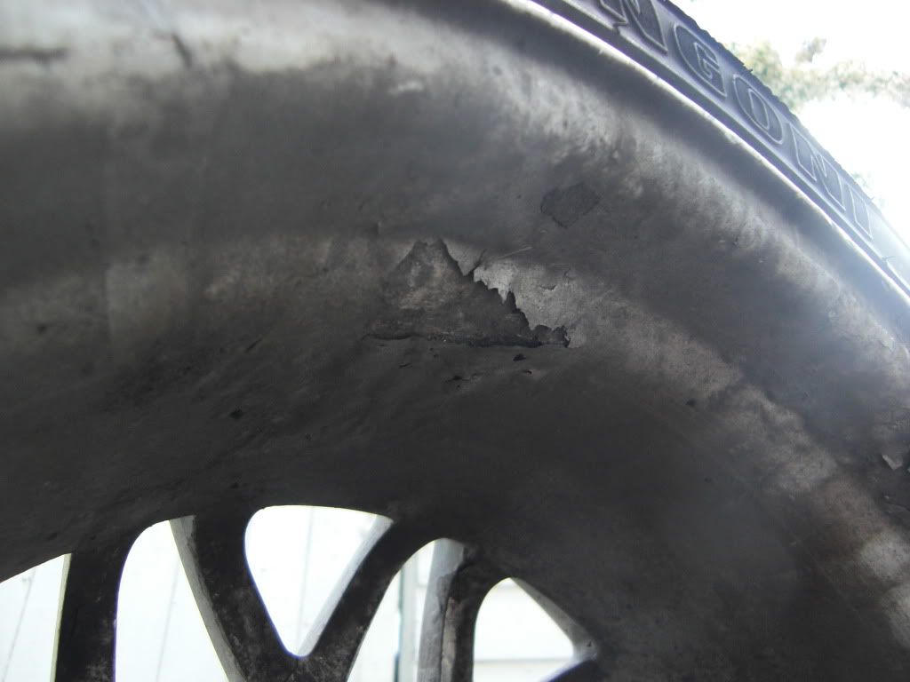

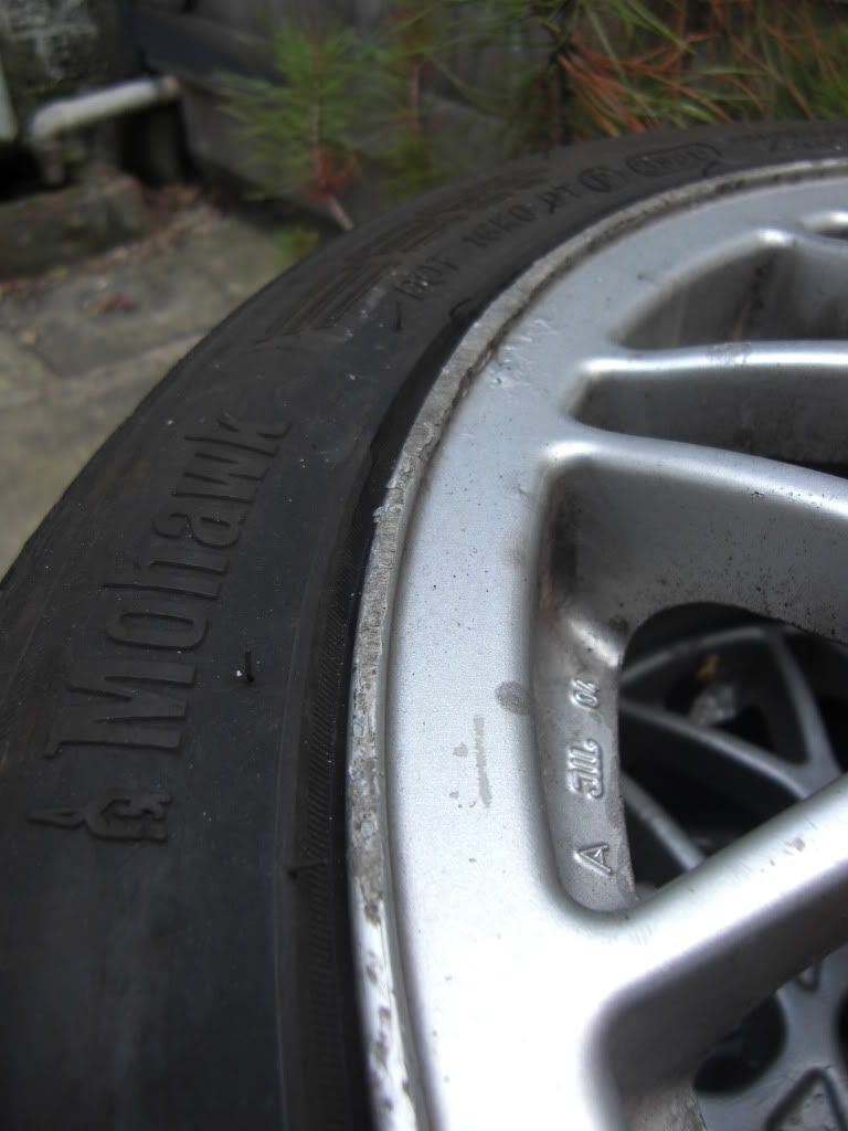

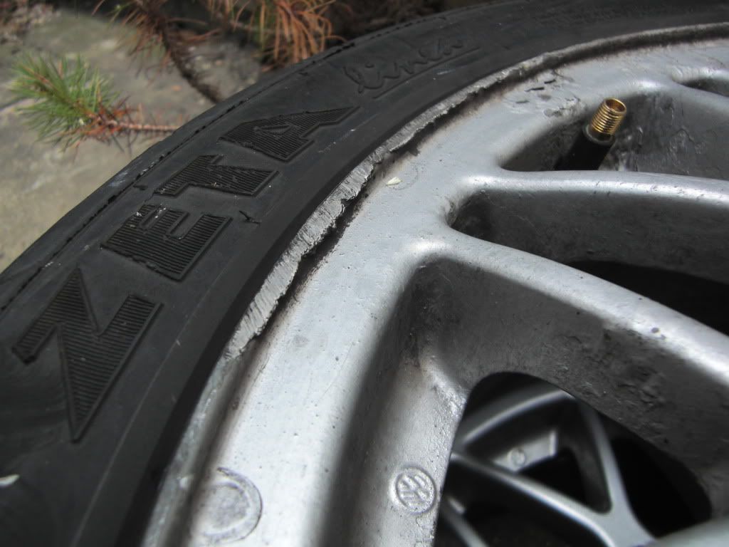

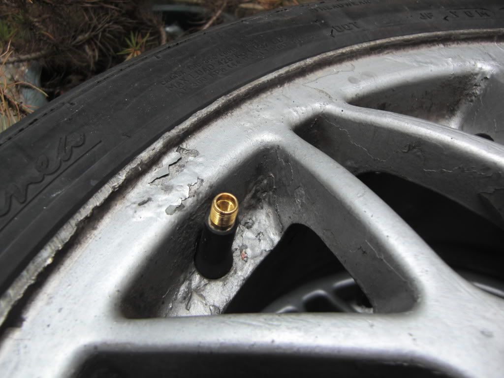

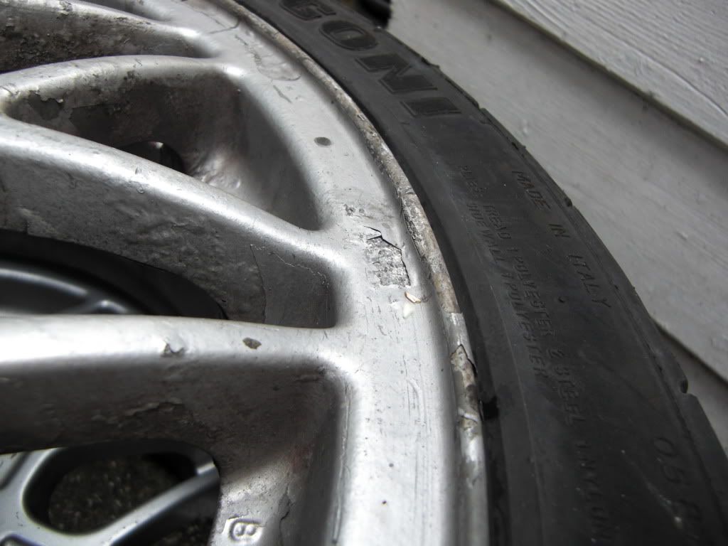

Time to refurbish my BBS VR6 alloys. They have VERY heavy curbing and A LOT of lacquer/paint flaking as shown on the pictures.
Some of the curbing goes around half of the wheel  :shocked:
So what I want to know is how to repair it. I want to repaint them in silver but before I do I want to sort out the curbing and even it out/ bring it back to new. This guide is pretty good, but if it's for small/light curbing, nothing on the level I've got  :grin:
http://www.bmwtips.com/tipsntricks/wheel-repair/wheel-scuff-repair.htm
So what would you guys recommend? I shall do a few heavy coats of primer to build up the layers and have a good base and a few coats of paint and lacquer too. Would you recommend buying a fine putty like in the guide and just doing my best to make the lip or just sand it down and leave it curbed?

Re: Alloy wheel curbing repair - what to use, how?
« Reply #4 on: 15 June 2010, 15:13 »
The only way to repair that rim is to have it built up with weld and ground back as required.
Also to be honest they need shotblasting
