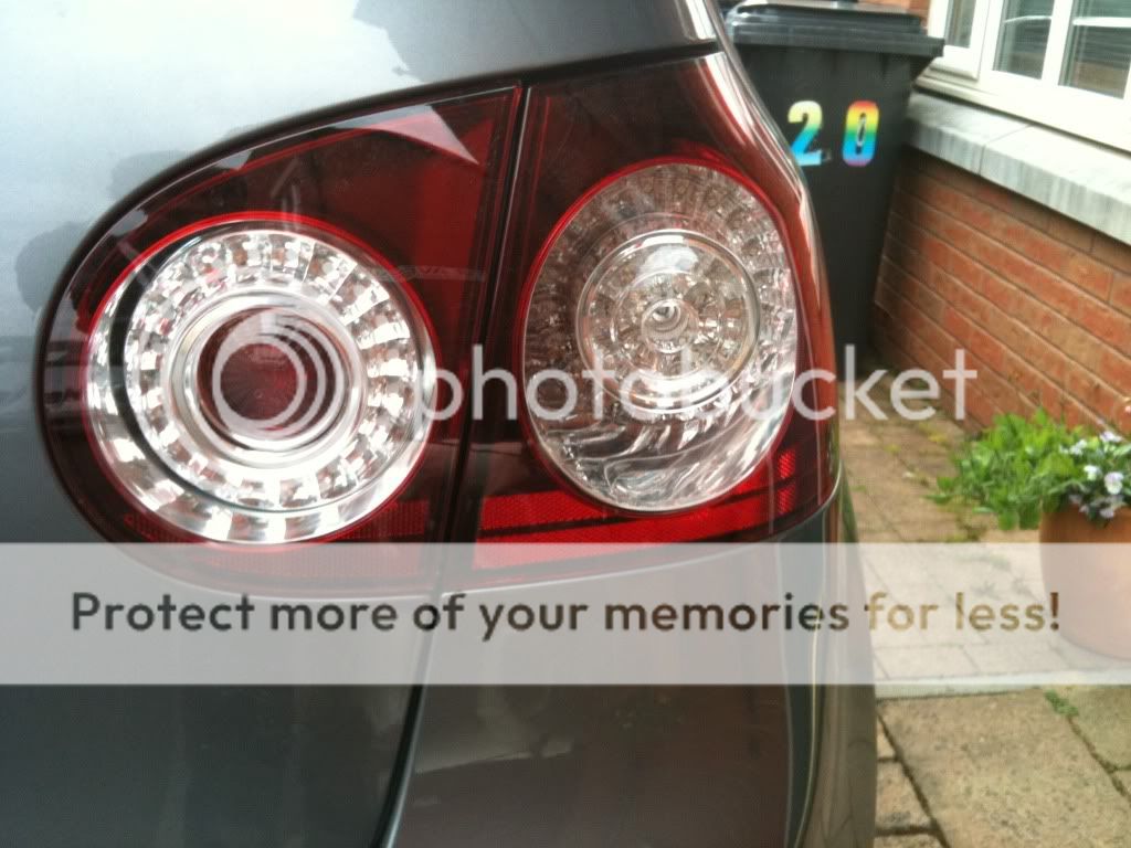

Check the inside of the connectors as one of the pins may have bent over.
May sound like the obvious question, but did you make sure you put the wiring connectors back in their ORIGINAL positions and didn't accidentally swap them over?
Its the outer unit so no swapping.  One of the pins did look a bit out of line but the connector wouldn't go anywhere near far enough in to reach the pins.
Offline Hurdy
  • Posts: 8,466
Re: MKV GTi LED's
« Reply #22 on: 30 May 2010, 09:56 »
Have you looked at the moulding to see if there is a fault with the connector unit itself?  They sometimes have raw plastic from the mould stuck on them, which prevents connection.
Seat Leon Cupra Black 290 DSG
Offline weston
  • Posts: 180
Re: MKV GTi LED's
« Reply #23 on: 30 May 2010, 12:15 »
Thanks for your help it's sorted now. Managed to clip it in by removing the back of the light unit and pushing the connectors together from both sides. Still don't know what was wrong but it's finished now :)

Offline weston
  • Posts: 180
Re: MKV GTi LED's
« Reply #27 on: 31 May 2010, 21:41 »
Oh Dam it!!!........... I need to get me some of those, more money :drool:
Do it! Well worth the money, and so simple to swap lenses and fit even I managed it :)
