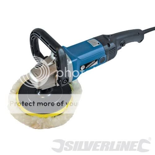

Bought this today, I know its not anything like what most of you guys on here have, but its a start  :smiley:

Looks very industrial! Let us know how you get on with it.

just be very carefull dude :wink: start on the slowest speed and work the polish and keep the polisher moving across your work area in a steady sweeping motion and dont push the machine hard onto the paint as this will inflict swirls and holagraming and worst case cenario it will burn through your clearcote/paint :embarassed:
woud highly recomend a coarse to learn how to use these machines properly as rotorys can cause alot of damage if not used correctly and are completely different to a DA.
once you master the technique of using these machines you'll love using it more and more :grin:

Cheers for advice chaps, I'm going to get a bonnet from a scrappy to learn how to use it properly first  :wink:
Will post some pics up when I've mastered it (and it stops bloody raining)
