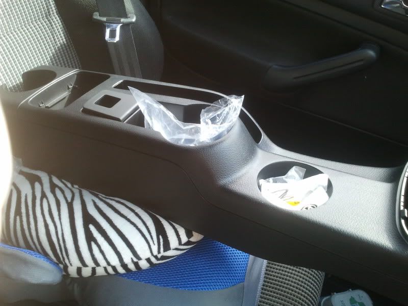

My US spec centre console has arrived, brand new from Mexico :cool:
Will get it fitted over the weekend :wink:

US centre console is in, then taken back out again as I need to adjust the handbrake mount holes to be able to move it over. I've got myself another handbrake mechanism to play with though.

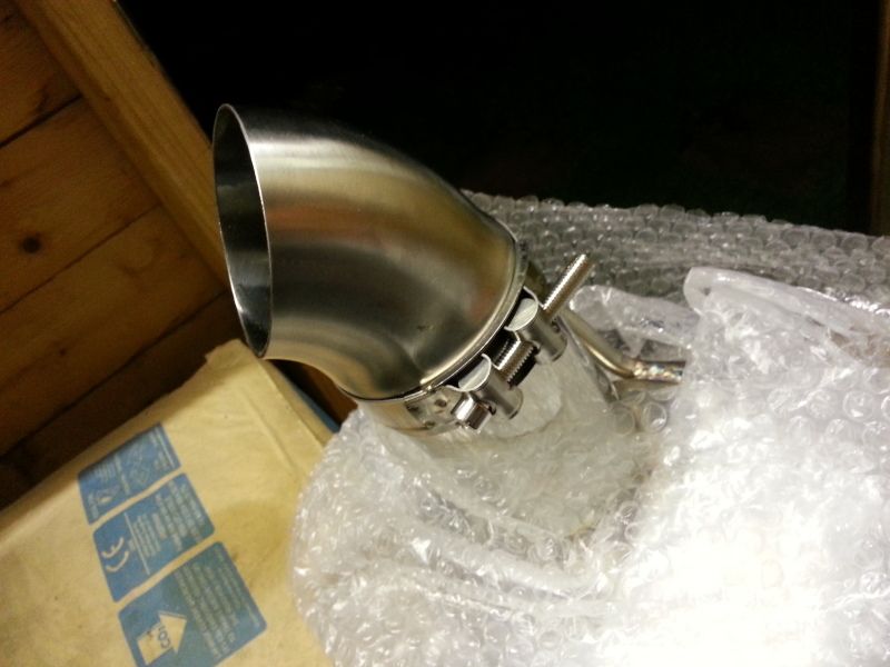

Hubs and rack are all paid for so they should be here soon. I've also bought myself the 3" exhaust system from the US which I had a bit of a nightmare with; box was damaged and I lost all the nuts/bolts and gaskets. Can't fault the seller though as I got a partial refund which was enough to buy a genuine turbo to downpipe gasket and some copper silicone sealant for the other join. I found some spring washers, bolts and lock nuts at work so that's all sorted. Just waiting on the tailpipe as I wanted a 90 degree downturn due to my Anni diesel valance rather than the one they provide with the exhaust.

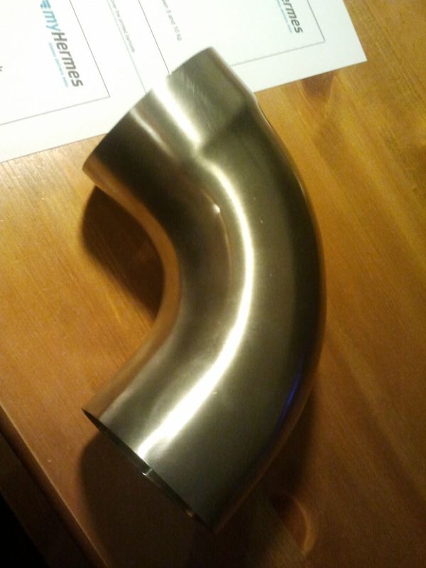

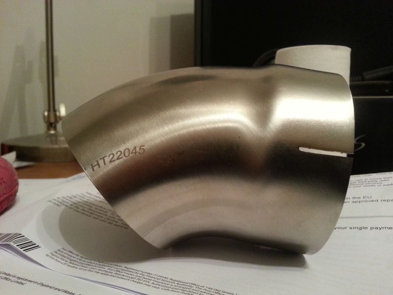

Finally got my backside in gear and sorted a tailpipe for the exhaust
From this
To this
Then finally
Should have it fitted next week :smiley:
