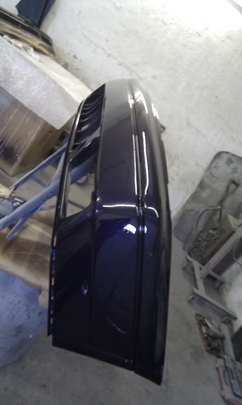

Bumper being painted as I type. Will pop into work tomorrow and polish it then get it on.  :cool:

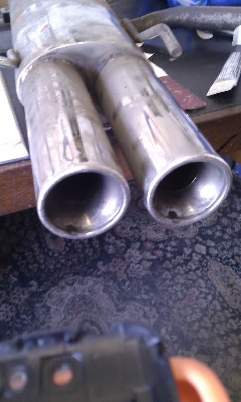

40mm 2m long flexi exhaust pipe plus twin tip back box =  :cool:.
Ran out of time and bodged the back box on but will get it sitting right but am just gonna buy a MK3 specific one.

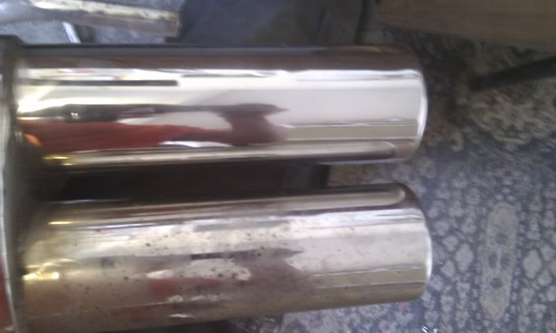

Was dirty but Autoglym Metal polish:
and:
Go to work tomorrow, give it a flat and polish and get it on.  :cool:

Bumper looks good  :cool:

Was a bit dissapointed when it was in primer but a few bits of sanding and filler sorted it.
Tip for you mate, do not push things together by putting pressure on things, it messes up the lines and looks ropey.Let it sit naturally and plastic weld it.

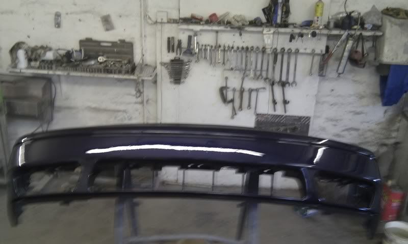

I assume you cut 3 sections from an old rear bumper and used them to infill it? How fiddly was the grooved section at the top to get right?
When I do mine Im going to plastic weld in my lower bumper air vents rather than just re-clip them back in I think. I just can't decide what to do with the indicators yet.  :undecided:
Just cut one big section out.
But I cut it a bit offset so the angle was a bit different by mistake.
Then I just lined it up, superglued it in place, got a clamp on, plastic welded then fed molten plastic into the joins with a mini blow torch.
The lines I just took an angle grinder to on one where it wasn't flush then filled. Came out OK though, they line up perfectly.  :smiley:
