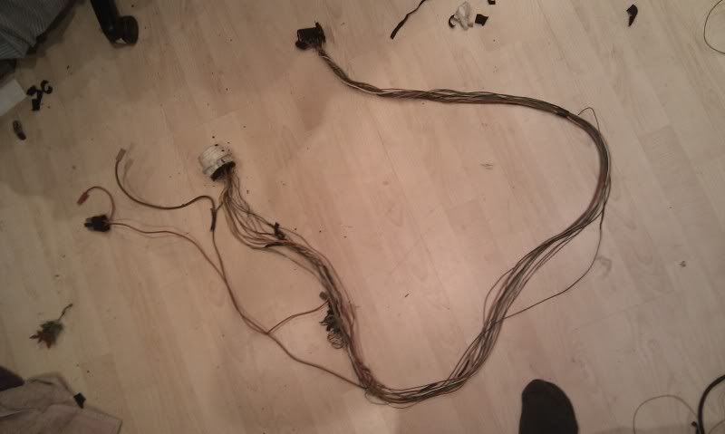

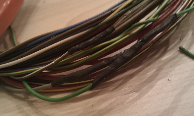

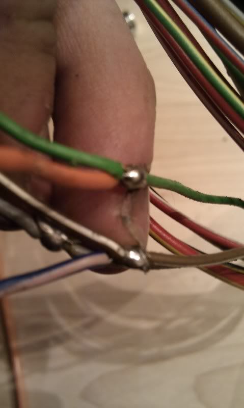

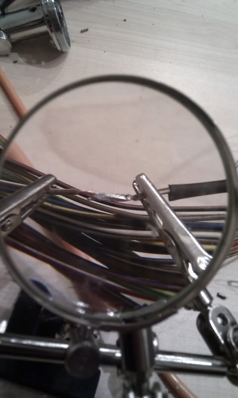

Took that lot first off cut the dodgy alarm wires:
Soldered:
Heatshrinked:
Then cut out this:
Left me with:
Leave the current central locking loom in there as it's more work and pointless changing that out. That loom there is purely front windows.
While I am there, I may run new speaker cabling direct to the headunit with a lot of slack, so that I can neatly run some far better speaker cabling to the rear of the car when I get my new amp.  :smiley:

Cheers mate. Nah I liked reading your thread. Trust me, garages will happilly twist and tape wires  :rolleyes: but even though it would be easy to chuck it all in, I'd rather take the time to wrap it and know it's in there, it's done and I don't have to worry.  :cool:

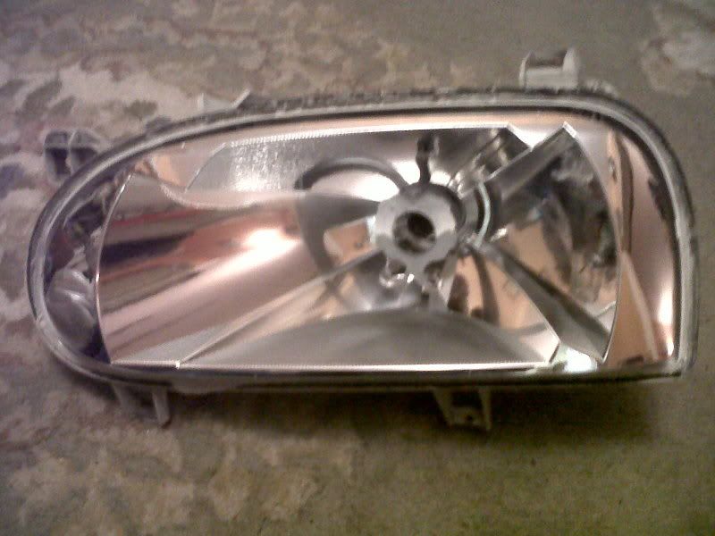

Taking it to work tomorrow, bumper getting primed up and a matte black Golf bonnet going on, badgless grill (all I have kicking around other then a GL one that's cracked) and CL Joey'd headlights, so gonna look mean and moody for a while.
Hi there i have cl headlights all apart atm and im not sure what bits to paint as most of its reflective? did you just paint around the outside?
Tab bit confused  :grin:
IS this the same as yours?
BTW is it legal? what i mean is will it pass an mot?  :smiley:
Offline Seanl
  • Posts: 2,559
Yeah the outside top lip bit. With the GTI lights theres a bit more of it being twins and they are corrogated. The lamps dont use that top bit so it wont affect lighting efficiency, therefore wont affect legality. :smiley:
