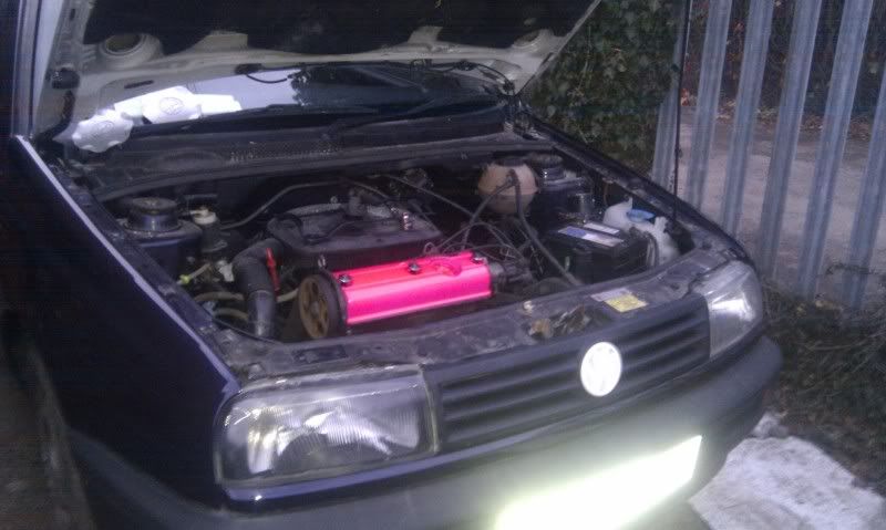

Cleaned up the bay a bit.
Re-routed my running light wires, as I ran out of heatshrink and am impatient I Scotchlock and taped it neatly. I ripped that off, soldered and heat shrinked and have run it neatly with the headlight wiring. It actually goes into the headlights as I didn't want to splice into the other looms.
I stuck the two wires in a drill though and slowly twisted them together so that they look as sexy as me.

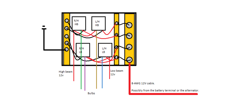

I plan now to relay the headlights, and thanks to Chris and Shauns project threads and their neat relay boxes I want one for the headlights and the horn which I plan to buy Wednesday.

A huge mass of complication.  :cool:
My dads fairly confident in making the box.  :grin:
Having an engineering background helps.  :cool:

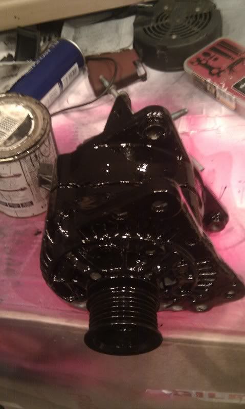

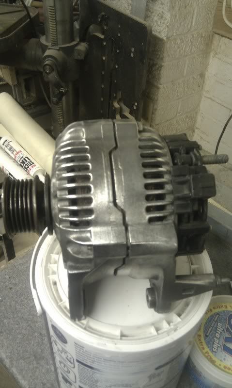

Took my really grubby alternator off, wire brushed and it came out like this:
Thought, why bother painting it? It looks really nice.
So I painted it?  :huh:
Sometimes I don't even understand why I do things.
Few bits I took off will go silver.
Needs another coat.
