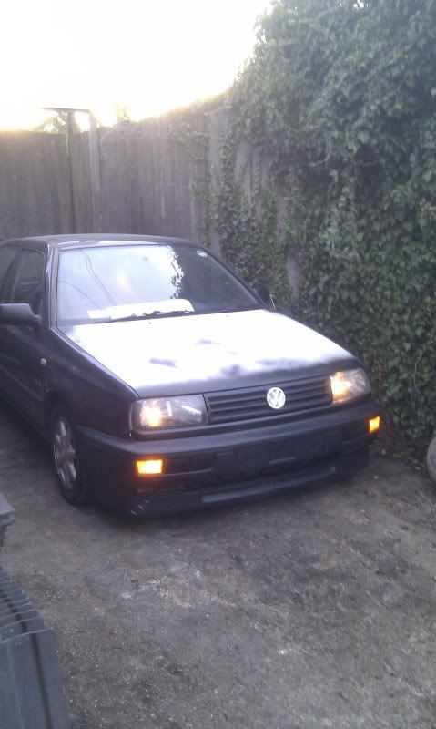

So I put all the bumpers back, full or primer but didn't really want to drive round like it especially as primer is porous SO
Found my old Golf's plain plastic bumper, whacked that on and then majorly pikey-teched a spare rear bumper I had in black.
Looks fairly smart TBH until Chrimbo when it's getting sprayed up properly.  :cool:
Took the grill lower strip back to the metal with 180 and zinc primed, 2 pack primed and have matte blacked it for now which I will use as a guide coat for rubbing the primer down when it's getting sprayed.  :smug:
Few stone chips on the bonnet, all rubbed down and primed, I'll block that down before college tomorrow and matte black it goes for now!

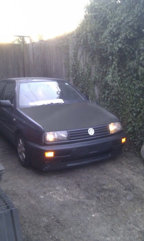

Got a white bonnet with primer and matte black as a guide coat.
Now discovered a fair amount of filler in the bonnet. Want to matte black it temporarily but my boss pointed out that aerosol is the worse thing underneath base coat for when I want to spray it.
I have a spare bonnet though so I'm gonna get him to see what he thinks about the paintwork and condition of it, it looks fine to me but I'm not a professional.

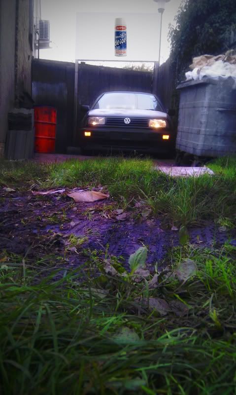

Is the front end.
Bad photoshop of the matte bonnet:
Suppose I better attatch the numberplate somehow. Used some trim tape and it fell straight off.  :laugh:
Don't want to screw it. Gonna order some strong magnets for it.  :cool:

Oh yeah that is cable ties on the splitter.
I drove it out the gates at work, hit a pothole and the car got stuck on the bumper and wishbone mount.  :evil:
Managed to get it off though.
Back suspension all level, passenger side to do then track it. I'll let the back down a bit more I think.
I wanted the wishbones all level for some handling but it was just too high.  :grin:
