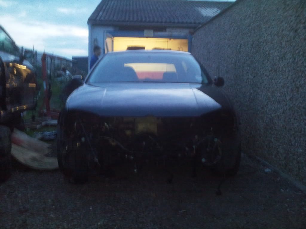

"Well today didn't go so well... We fitted the top mounts and they work LOVELY...however... We were packing up and just leaving for home when pop turbo shaft snapped. Chris has a picture somewhere of the shaft...
Oil went through everything, hydrolocked the cylinders...so possibly bent valves...also noticed some nice bits of metal in the inlet ports so probably need a rebore...However...when we took the plugs out and turned her over she spat all the oil out and turned over nice and smoothly. So fingers crossed not too much damage...
So from 3 in the afternoon till 9.30 ish we accomplished this...
The oil from the intercooler:
Me in a jolly mood thinking wahey big turbo...lol:
And how she is sat now...reminds me of a couple of months ago lol:
Dan"
