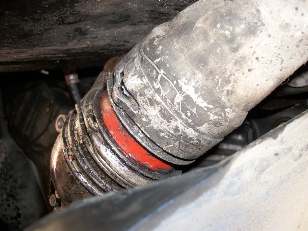

the clip part was loose hanging off and the piece the clip clips onto is bent!!! would this get me a boost leak??? its form intercooler up.

yep  :smiley:
deffo leaking boost from there!

cool beans!!! can you see where the clip is bent mate?? what the best plan ? get a new pipe is it??
depends on the condition to be honest.  If the lugs are ok then get some new clips and o-rings and put it back together
Otherwise new hose time

wheres best to get new pipe?? how much? also is it poss to get silicone pipe?
its a dealer only part
what engine you got??

130 tdi 2002 reg - ys02xoh

I can see the red pipe also on when I look through the drivers side wheel arch. Should you be able to see the red pipe? or should it be closed off completely?

my pancake pipe looks like that :lipsrsealed:

that pic looks like the back of the pancake pipe to the red turbo outlet pipe??  you best hope the red pipe ain't got a leak - its £100
you should be able to see it go into the rear of the pancake pipe but obviously it shouldn't have any holes in it!
