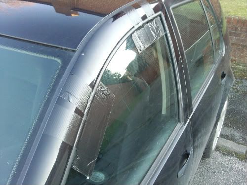

ok would i be able to just buy a full door in black from a scrapys and do a straight replace or get one from a different colour and replace the inners?
This is how my car stands atm, i do like the colour coded tape lol  :smug:
