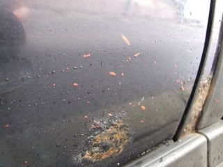

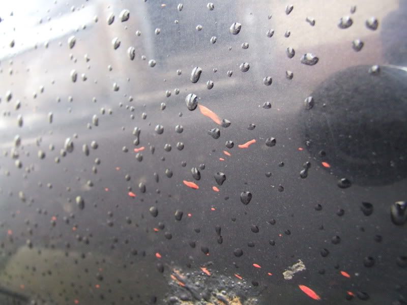

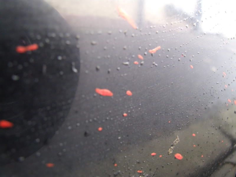

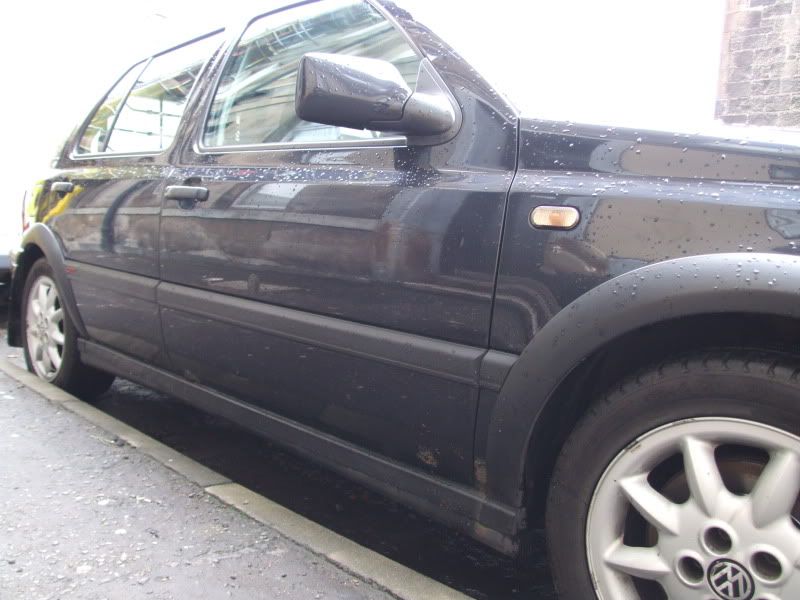

hi guys
photos of the paint splashes below (and the %&**^% rust bubbles - summertime job!) .  the red paint splashes are def an oil based paint or enamel and look like car paint (or poss gloss?).  Kind of looks like a previous driver drowve through a paint puddle as rthey are on plastic trim behind wheel too.  any sugestions how to get off without ruining my own paint?  ta

thanks for getting the pics up dude :wink:
right looking at that i dont think tar and glue remover will touch that tbh, i would tackle it with some wet n dry 2000grit or higher and rub extremelly gently over the red splodges keeping wet at all times with either water or a mildly soapy solution till they are removed completly then polish out where ive rubbed with some medium to fine compound on a rotory polisher, you could polish after by hand if havent got a rotory or a Da but you need to have a good technique to acheive the desired result.

if your superbrave a paint razor will remove those (use them to remove runs in clear coat ;) )
