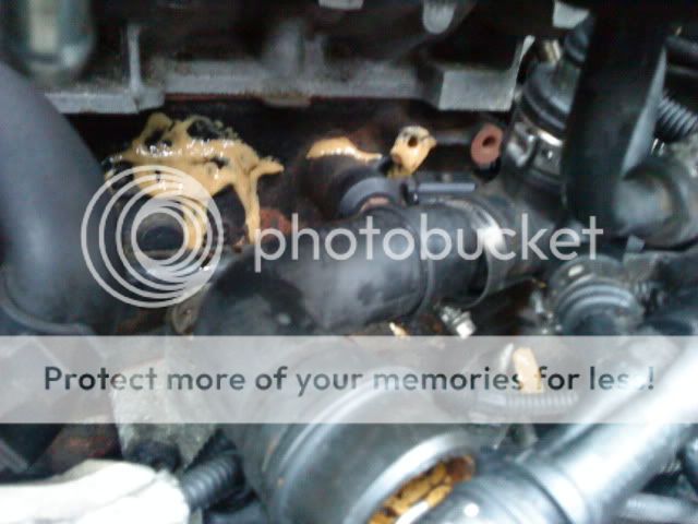

Removed and cleaned out this little lot:
This creamy gunge is what spilt out when I removed the pipework:
« Last Edit: 19 February 2010, 14:50 by Mr_Orange »
Build thread clicky

You need a catch can mate! :afro: Sod paying VW prices for all those pipes when they can be replaced with a fresh looking catch can install:
EDIT: What ones you got to replace mate?

« Reply #16 on: 13 February 2010, 16:43 »
The 3 soft (not solid plastic) ones will be coming back out.
Build thread clicky
