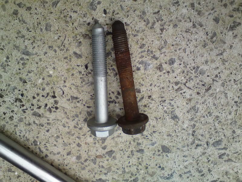

Dave and myself just replaced all my shocks on the weekend and in the process renewed
Front top mounts
Front bumpstops
Rear bumpstops
We also renewed the bolts holding the shocks too and this is why you should replace bolts

i'll be doing a how to of the job but here's the part numbers of the bolts we replaced
AN 102 861 10 - 44p each
AN 101 064 02 - 65p each
AN 102 078 04 - 1.72 each
AN 905 173 04 - 1.08 each
You could also replace the bolt holding the anti-roll bar drop links and the two bolts holding the rear shock in place but we didn't
We replaced the 4 shock bolts as they had been on and off the car several times
