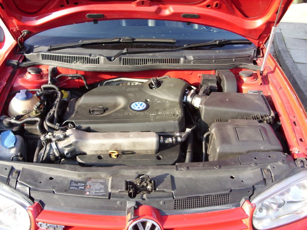

The car does need some work but its just has a water pump, oil pump, sump cleaned out including the strainer and lots of stuff. Its a bog standard 1999 1.8t though there are some parts missing and think it has had a non recorded front end bump ~ is the slam panel across the front normally the same colour as the body? as mine is black. The car is straight and I had a 4 wheel alignment to ensure. I knew what I was buying and I was aware that as a 10 year old car its seen so adventure, but this is a run about also a tow car for my track car or fun car.
Firstly when I start the car the will blow in warm air but as I drive it cools back down, then when I stop it has chance to warm up again. I think this is just thermostat.
I opened up the engine bay to have a look round and noticed that by the bonnet catch there is a small micro switch hanging down but I can't see where this little fella goes? any ideas? I think when the front was sprayed something was removed and hence its hanging there.

The slam panel being black is normal does it look like this??
 not sure on the microswitch hanging, has it ever had an aftermarket alarm fitted?
sounds like your thermostat in relation to the temp or poss an airlock what temp is your gauge at?
The GTI lights are smoked  :smiley:

Yes the slam panel is black, that is ok then I am pleased about that

I will get an actual picture but it looks like this, but it does look stock.
My alarm does chirp off the stock key fob so there is a chance there has been an alarm fitted. I do not yet know much about this car but I am working on sorting it out
