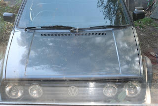

I bought my car about a year ago and it was always intended to a project. However the day before I was due to collect her the cylinder head gasket blew in my daily driver (Rover 200 who would have thought), so I was forced to press the Golf into service. Heres a picture of her as she was before I collected her.
Specification:
Golf GTI 8v
Seat Wheels (sprayed black no primer)
Lowered (chopped springs :shocked:)
"Racing" seats (Ripspeed type recliners)
Jetta front end
Few ripspeed bits and pieces (ariel, gear knob, handbrake cover)
Single wiper (modified linkage)
Not a big fan of cars modified in this way but a really nice clean car to start a project.
