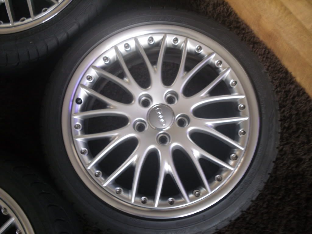

Ive got some 18" audi splitrims sitting in my garage from my previous Audi A3 54 plate. I am thinking of putting them my new GTI, does anyone out there know if they will go straight on without any issue's?

Yeah they'll fit fine.
The only 5x112 pcd Audi alloys to watch are ones with less than ET40 offset and some of the newer big engined Audis which have slightly different hubs to the others. A3s are basically Golfs so you will have no problems.

Yep! as above.... i know because I have the 19" version of these wheels :evil:

Maybe worth posting the ET number of them.

Yes sorry ET54

They are immaculate due to a recent refurb (split down, bolts removed etc and had the outers polished) cost £320 for the refurb and also have brand new tyres fitted(falken fk452's done about 100 miles)
