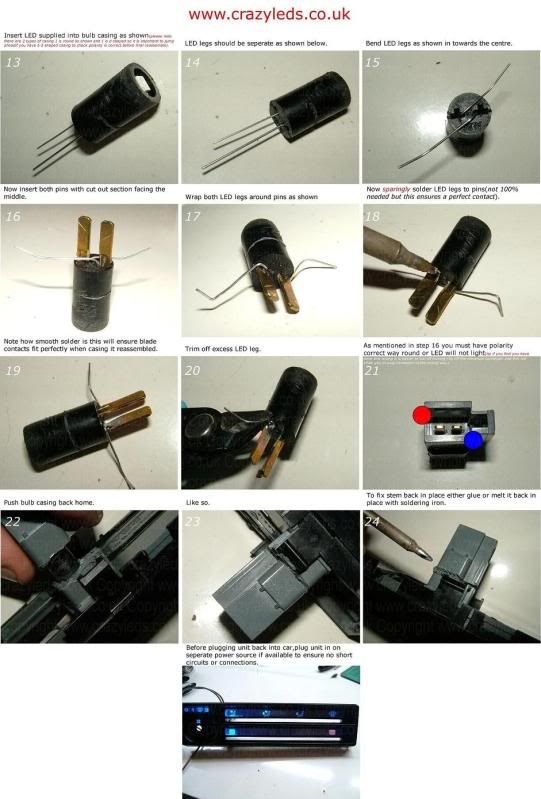

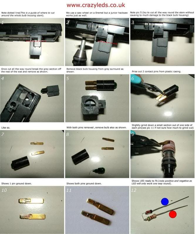

Got a some instructions to do this when i replaced it with leds. Can mail them to you if you want?
I'd be interested in this too if that'd be cool too

« Reply #5 on: 16 November 2009, 21:48 »
Nice one squirrle cheers for that
I'll enjoy swearing when i sort that when the rest of the dash is in bits... :wink:

« Reply #6 on: 17 November 2009, 08:35 »
Thanks to those who replied + the photo steps! Wow!
