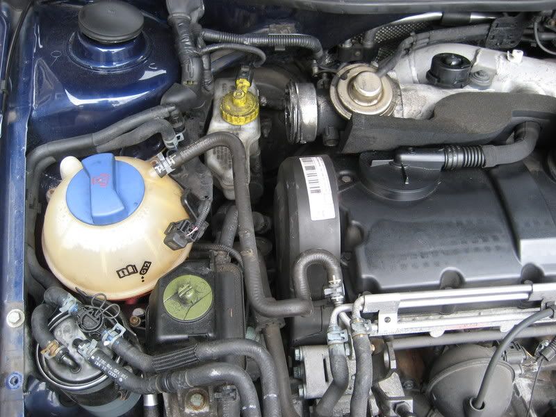

can you spot it in this picture
Offline smooth8vgti
  • Posts: 75
  • Needs to be LOWER !!!! Much Lower
Re: What is this as its leaking ???
« Reply #6 on: 07 October 2009, 21:29 »
Yes its at the bottom right of the picture below the header tank
Offline Rhyso
  • Posts: 26,687
« Reply #7 on: 07 October 2009, 21:30 »
you mean left, right?  :huh:   :grin:
that is 100% the fuel filter then  :smiley:
new one is approx £20 from your local dealer and is a 5 minute job to change
the thing with with green cap is your power steering reservoir

no worries.  Strange its leaking though  :undecided:  check the pipes haven't got any split or cracks in them
