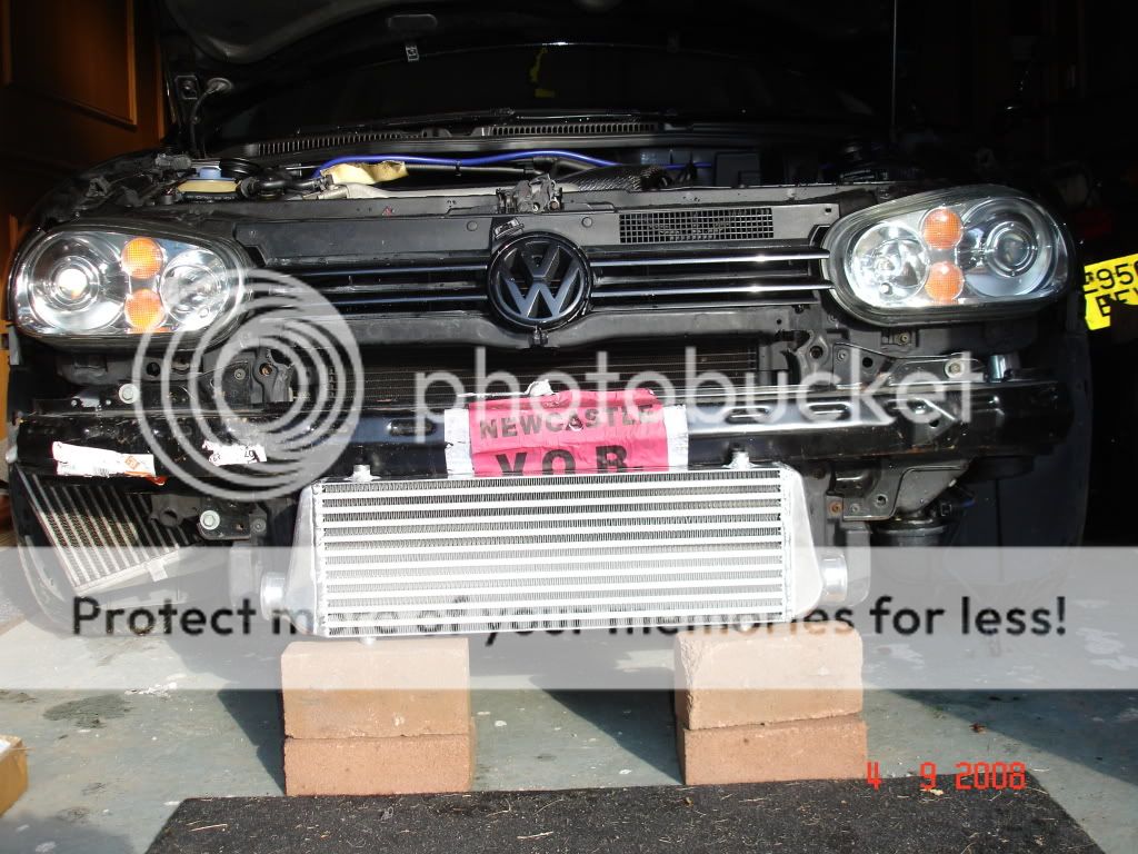

ok so the intercooler turned up and it was time to start mounting it to my car.......
firstly i removed the r32 bumper which required taking the grille off. This clipped of which revealed some bolts which held the bumper onto the bumper bar. once these were removed all that was needed was to turn the wheel to one side and remove the torques screws which held the bumper to the arch lining. lastly there are two bolts inside the grilles on each side which held it on. after this the bumper just slides of.
secondly it was time to mount the cooler in the correct position i did this by propping it up with some bricks. by doing this i could see where the cooler would sit
Here is a pic

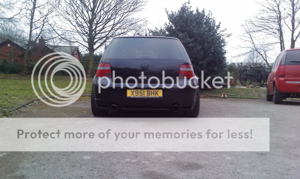

Inbetween all the engine modifications I decided I wanted the car lower on the back end. So I spoke to ‘venom motorsport’ which again is not to far from where I live. They agreed to split me a set of FK highsport coilovers, so I could just have the rear ones.
I also bought some  spacers 15mm hubcentric for back of the car and 5mm for the front, this made the car sit so much nicer IMO. Here are some pics of me fitting my new coilovers and also the new spacers!
and the spacers....
this is how it then sat....
