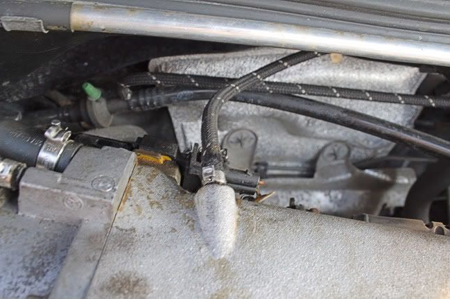

Ok couldnt see any crack in the dizzy cap , and the relays were warm all round, but i didnt notice the hose in the below picture is looking a little nackered, i fiddled with it this morning whilst the car was running, and the car misfired even more on the go, so maybe this is my culprit, any ideas where i can buy this from today?

Cant see pic but if this is the hose up to ECU then that is your problem!
Get some fuel type hose, diesel size is best.
