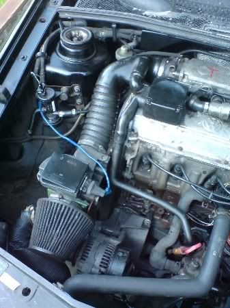

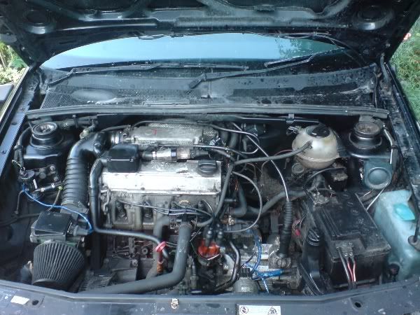

I've taken some pics of the engine bay so anyone can see if anything looks majorly wrong from the pics:
Large scale images available.
After a Wiring diagram for this model and year to if possible incase its something wrong there.

Interesting... I'm just wondering and this is a bit of a curve ball but how long has that induction filter been there? It looks mighty close to the engine in your pics and from what i can see looks quite dirty... It could be as the engine heats up she's sucking up the heat from the engine and that's causing you problems. I can see you have some sort of cold feed there but even so.
Just a thought.
Andy

Im thinking that funky wiring on the MAF might be up to something.

+1 also what is the unit on the inner arch, never seen one before.

Oddly enough, there's no reason for all that blue tape. There's no modified wiring there at least anyway. His interior wiring was a little bit "interesting" but that was soon rectified and everything now functions 100%. However the engine continues with this problem. I will investigate this wiring further incase something was missed.
Does the 2E run an Inlet Manifold Temp Sensor before the MAF as I've seen in some later 8v GTi's ?
If so, mine is not there any may account for the extra unused earthing point ... ?
Tbh I've never really paid much attention to that. I will take a good look and take some more pics.

The maf / wiring / air filter all looks bodged to me.

I agree wayne. Would take the wiring back to where it joins, and replace it.
