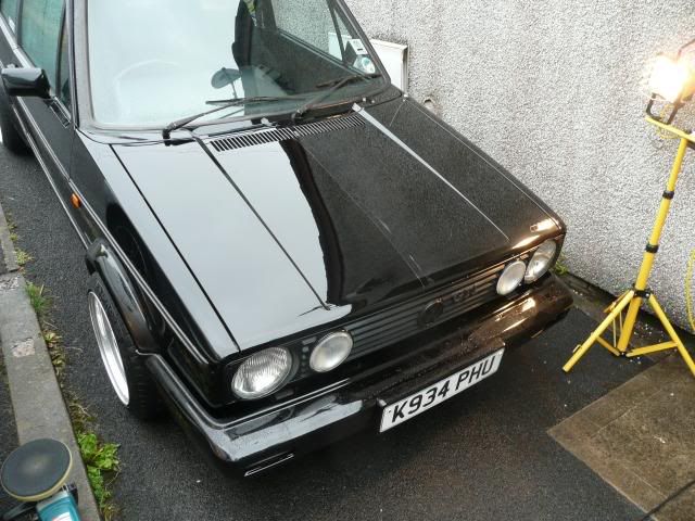

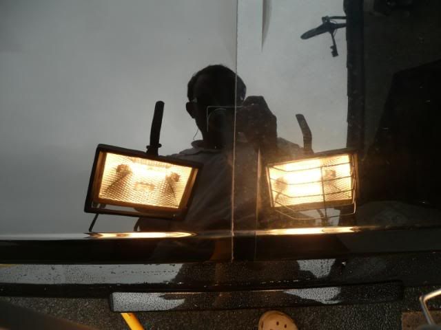

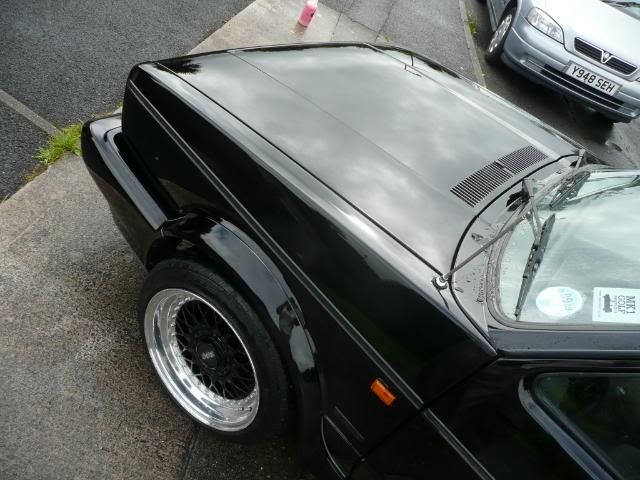

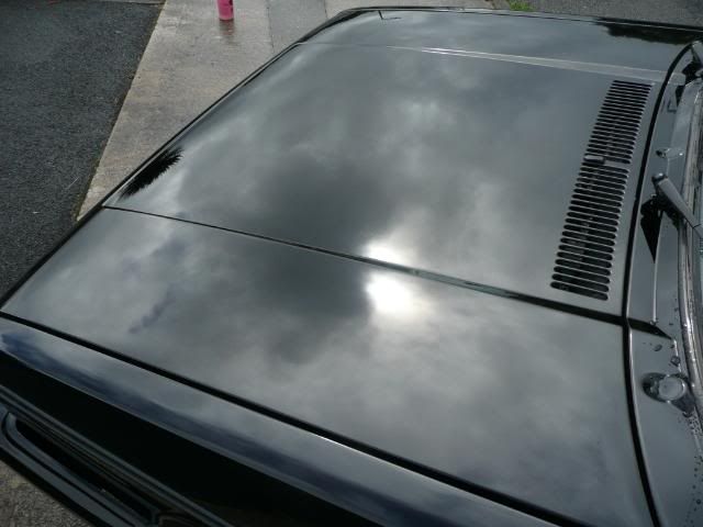

Basically, the swirls would NOT come off the bonnet.
I did it section by section, one area at a time.
First - the compound glaze. About 10 - 15minutes of that with the compound pad.
Wiped down, then the same again but with the intensive polish on a lighter cut pad.
Then I used the final polish for about 10 minutes on a polish pad.
Once I wiped the polish off, there were still swirls :@ I think it was down to me wiping the polish, it seemed to smear.
So I did the whole bonnet again, and I think I've cracked it.
Did exactly the same and then used the DAS with my microfibre cloth to remove it (after using the final polish)
Pics soon!

2nd that on what guy said :wink: we does it daily dude :grin: and love it :drool:
were you pressing very hard? swirls and holagraming are normally a simptom of pressing too hard.
