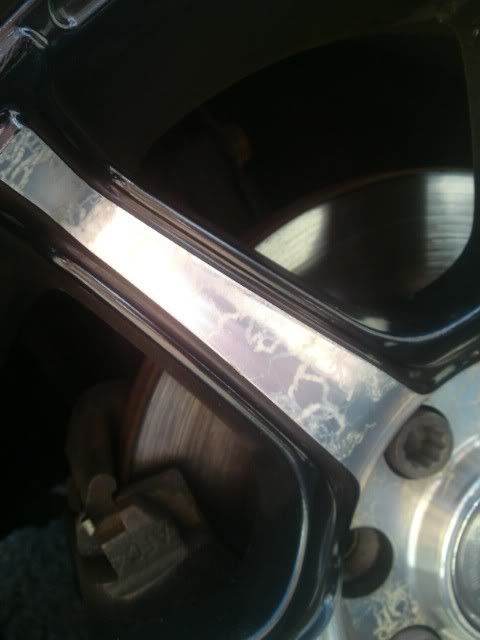

<a href="http://s973.photobucket.com/albums/ae214/weazgti/?action=view&current=DSC00113.jpg"
What can be done with these then.sorry took so long to post pic but took ages to work ou photobucket
That looks like an issue with laquer to me... although im no wheel guru lol..
yep that's the lacquer peeling away
that yellow ish colour is where water has got underneath the lacquer

your options with them are either strip the wheels and have them painted/powder coated
or if you want to keep the "shiny" bit then it may be possible to carefully remove just the lacquer and then polish,
to replicate them as they came from the factory would probably not be economical! (powder coat - diamond turned - lacquered)
good luck  :smiley:

cheers for the advice,not really worth spendind money on getting powder coated so ill give the polish a go.Would i need to use fine sandpaper to get the lacquer back or would compound do it?Do i need to re lacquer afterwards?
p.s why when i put the link code in from photobucket just come up with a link and not my pic? how did you do that
