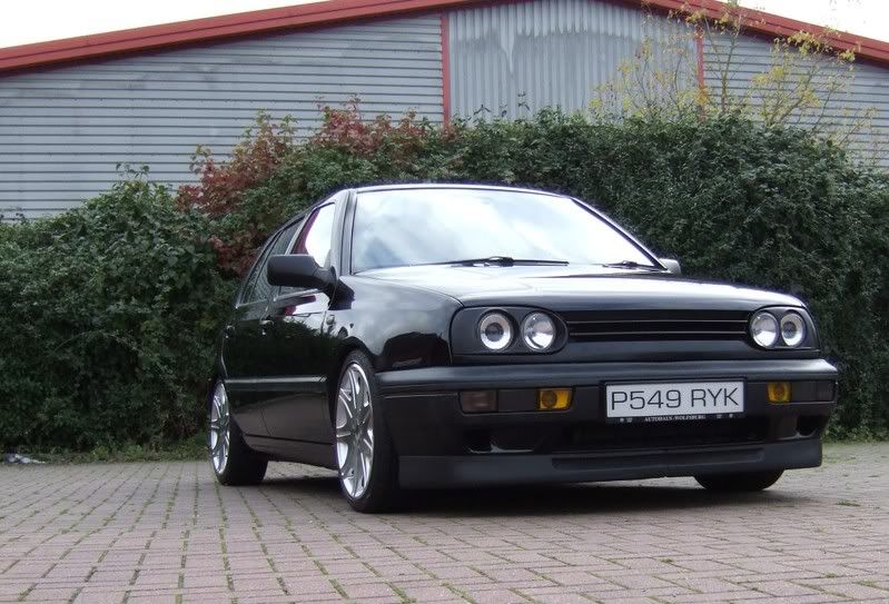

This was the lowest I could get on 17's with coilovers..

By the way, that was with rolled arches/trimmed GTI arches. Wheels were 7x17" ET40 front, ET30 rear, 205/40/17 tyres. It still rubbed though.

This was as low as I could run mine on 17"s, the rear arches were trimmed back but even with camber the fronts would catch now and again.
