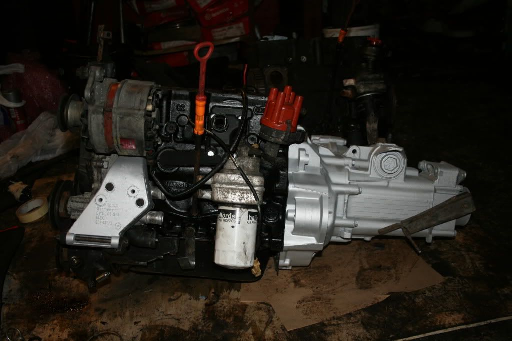

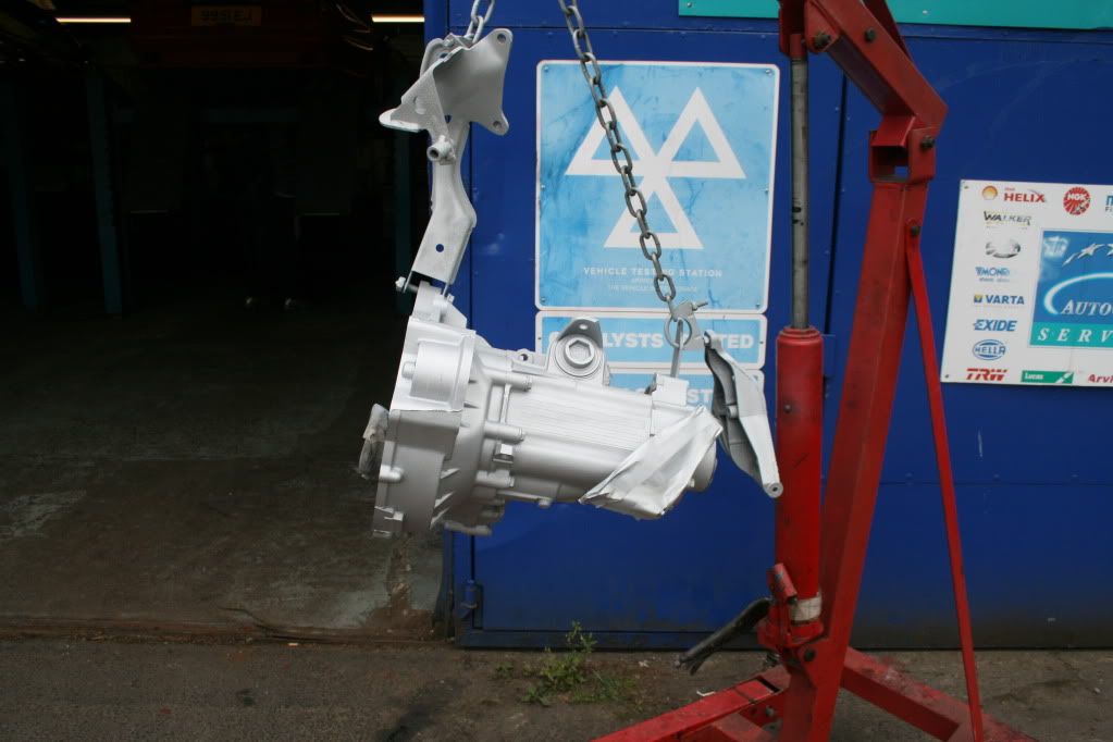

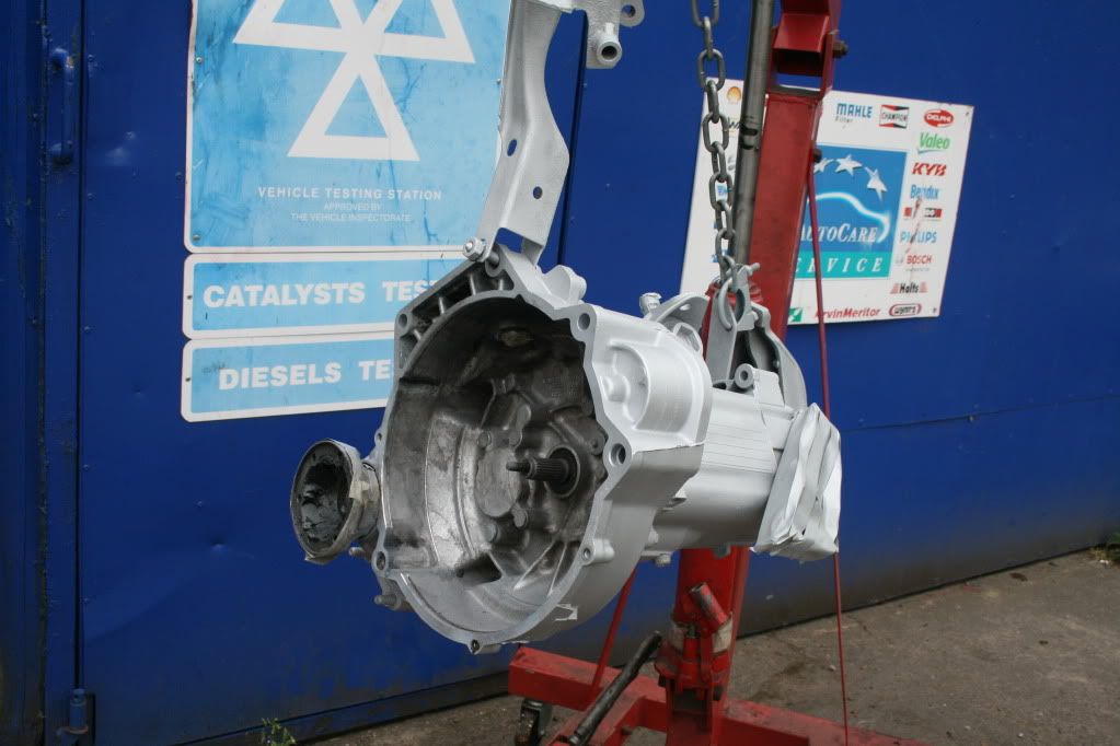

Popped down to do a little more yesterday afternoon. Progress was a little slow as can't really do a great deal until the head comes back from the machine shop. Should be Tuesday hopefully but I then need to juggle the car and work and unfortunately work has to come first.
Anyway, I did manage to get some paint on the gearbox which was absolutely caked in 20 years of oil and grime. Props to my mate for scrubbing that up for me whilst I was away  :grin:
Bottom end is pretty much complete now. Just need to drain the old oil in it, replace the filter and clean the pick up pipe for the pump. Swap the engine mounts, get the head back on and we should be good to get it back in the car.

Gearbox looks good mate, what paint did you use?

Engine is back in now but unfortunately no pics. I've been swamped with work so little time for anything car related. Gearbox was just cleaned up, 2 coats of etch primer and then standard high temp autofactor stuff (Simoniz I think).
