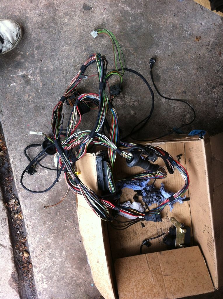

Made a bit more progress over the bank hol weekend although progress was a little half arsed if I'm honest  :grin:. Enthusiasm is waining slightly but picked up again when the loom arrived after RJ worked his magic on it. He's done a spot on job - all in place roughly but couldn't tape it up as ran out of loom tape.
Quite a lot of loom to stuff up into the scuttle
Best routing I could see for the ECU vac line - this correct?
Plugged the airflow sensor in on the airbox. Thought I'd lost this little bugger.
I think I just pop the ABF transponder wire onto the column instead of the black collar already on there?
Any tips on getting this to sit properly in the bulkhead appreciated. The biggest **** of a job I've done for a while, gave up for now lol
Slowly but surely getting there - front end and lights back on, all connected up
Hopefully crack on with plugging the rest of loom in one evening this week.
