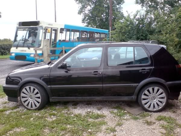

This is her btw:
Offline alien.46.uk

Looks a nice car that mate. Swap the wheels for some 15" Multi spokes lol.
