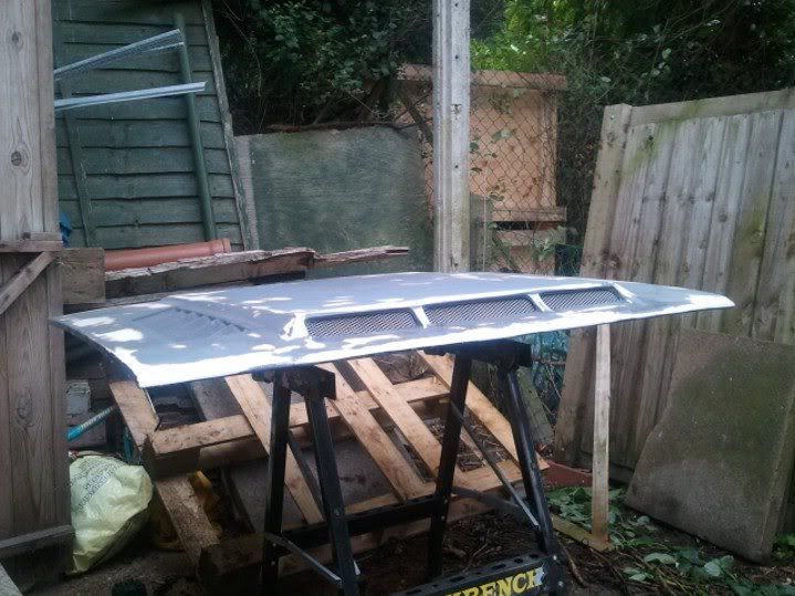

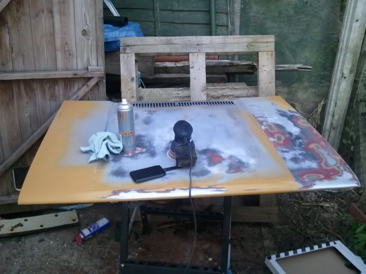

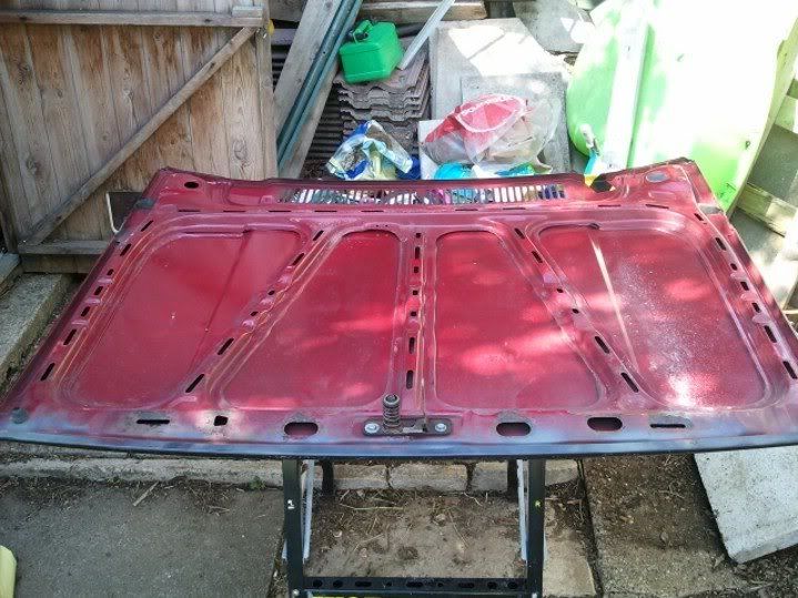

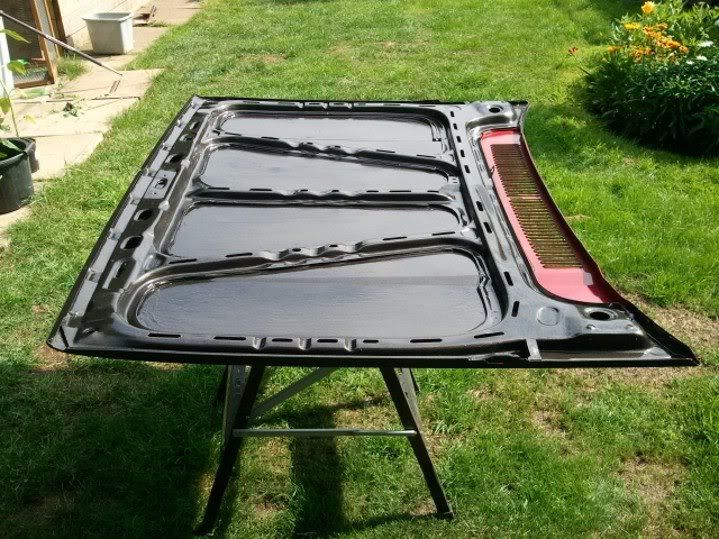

So today I had some time while the missus was out. As soon as that happened it decided to rain. Did what I could, attacked 2 bonnets up to the point of painting..... almost:
Couple of weeks back I made a start. Took off the bonnet the old girls been rocking with, bought it for a tenner ages ago, slapped some paint on it which showed all the dents and scratches and drove the car about.
Time to make good

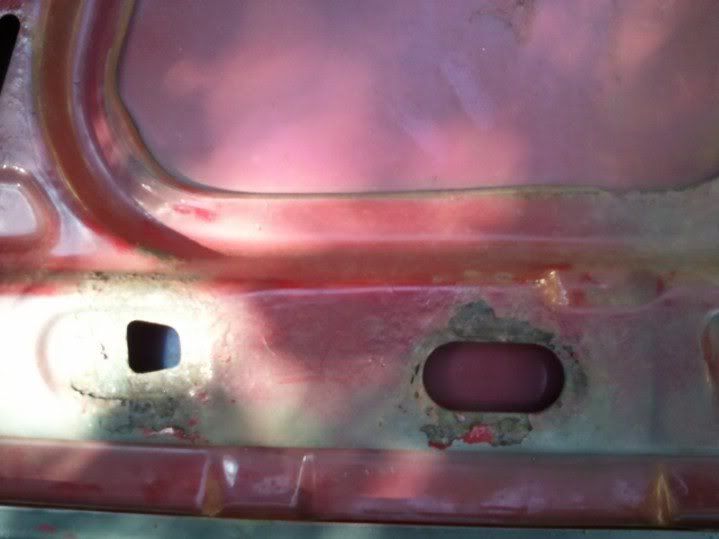

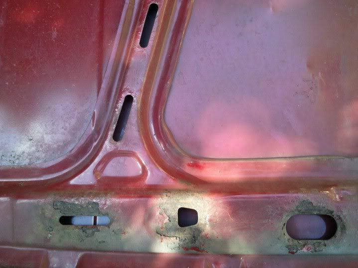

Underneath it's pretty far gone in places with the old tin worm, eventually I will have to source a mint one when the time comes for a pro respray
Cleaned it up best I could
And since it's the underneath and the metal has had a hard time, it was hammer(ite) time.

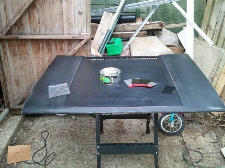

Started on the important side, as posted before this went horribly wrong when I got lazy and used some filler primer on some small marks. Reactions and shrinking and swearing! When it comes to bodywork, don't be lazy!
Invested in an Orbital Sander after all the pain, yes the rest of the car has mostly been done by hand until now as the normal sander was sh*t!
Dent free, smooth and waiting for paint.

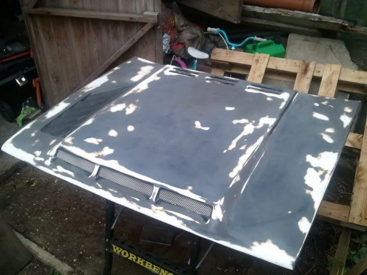

As the rain got worse I worked on the Quattro bonnet in the shed as I thought it was about time... much nicer to work on. It has a lot of damage though as it was in a barn for years! Need to work on the back corners as they are shot from being sat on them the whole time.
Hope to be wearing it by VW Action although it looks like I'm going to have to use bonnet pins.
Thanks for looking.

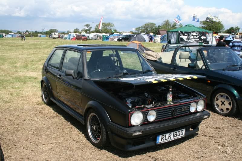

Delayed update from August 04, 2011:
Got VW Whitenoise tomorrow (5th August) and haven't finished the bonnet so instead I slapped the totally f**cked spare on and now it looks like this!
