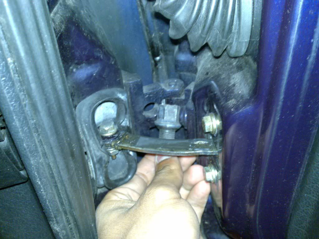

Right, only thing you need it a wheel bolt.
Step one: Place it in the BOTTOM hinge of the door, hold it there with your hand like this.
Step two: Close the door slightly so the bolt makes some pressure on the door and doesnt fall down. Like so
Step 3: All you need to do now, is using both hands, gently and steady force the door closed. Obviously it will not close, due to the bolt being stuck in the hinge, just keep forcing it slowly, it will need some decent pressure to do this, dont under do it and obviously dont over do it.
After a little bit of pressure, open the door, let the bolt drop, and close the door, see if its any better. Keep doing this until you're happy with the results, I repeated steps 1, 2 and 3 about four or five times until I was happy with the alignment of the door...
If you over do it, and raise the door too much, then do the same procedure, but on the UPPER hinge to bring the door down again.
You do not need to losen up anything, just wheel bolt in the hinge, and push the door close, and repeat untl happy.
