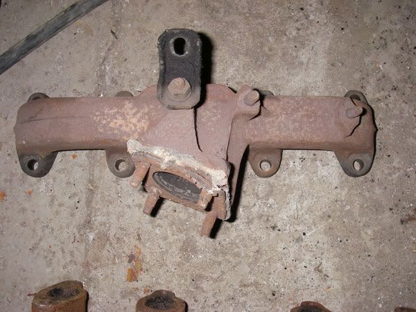

Thank the lord, the Exhaust manifold is Off!!!!
The trick seemed to be heat from my new burner (thanks danny) , some plus gas and a bit of welly from my mole grips and smaller sockets. Still tight but they give way apposed to snapping.

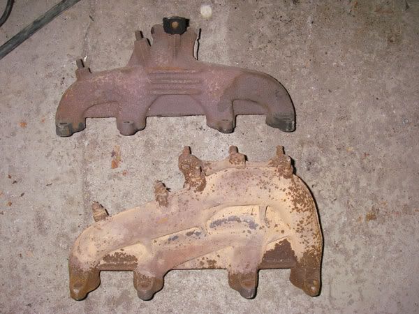

My new problem is now sourcing a manifold that I can use as a replacement, it will need to be pretty much the same dimensions as its tight in there and i want the old down pipe to fit into it.
Problem is this manifold has no part number on it :( Does anyone know if all other mk2 and mk3 manifolds that are single outlet are orientated the same.i.e. the joint that connects to the down pipe is same dimensions, are they the same angle / pitch etc?

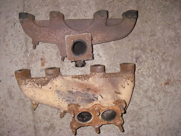

« Reply #38 on: 23 May 2009, 12:20 »
So you want one of these.
But, really you want one of these:
Because there are two outlets, like this:
So it'll breathe twice as well.
I have both of these sitting about......  They're in Bristol.

Another update...
ok so i have both maifolds off, but now there are 4 studs left in the head that i would like to replace.
Would this kit work...
