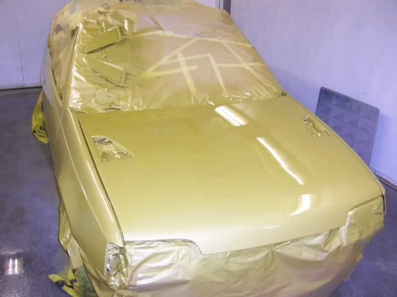

this was with the last coat, you can see the finnish has got some shine, it didnt take long to polish up :smiley:
