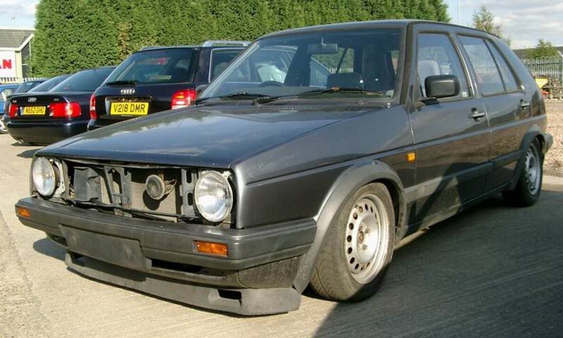

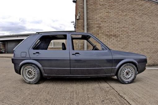

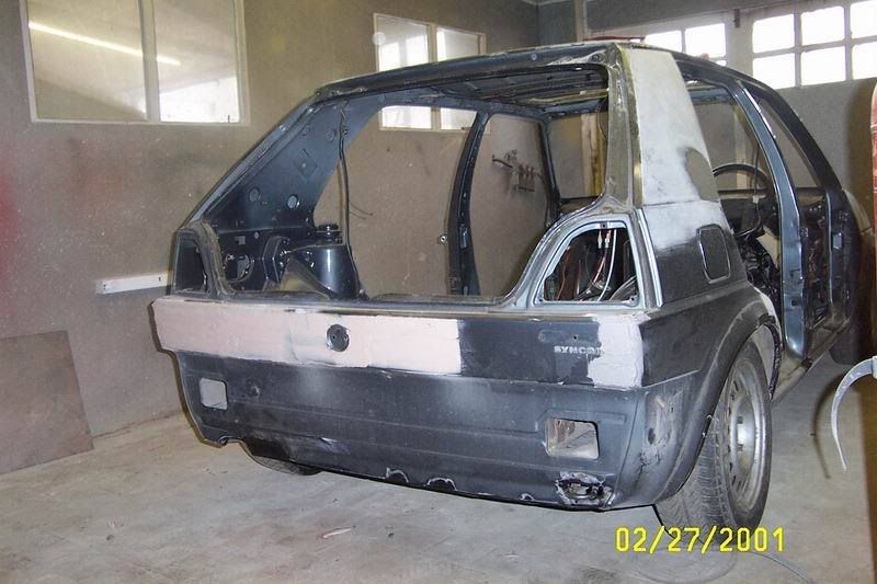

My car

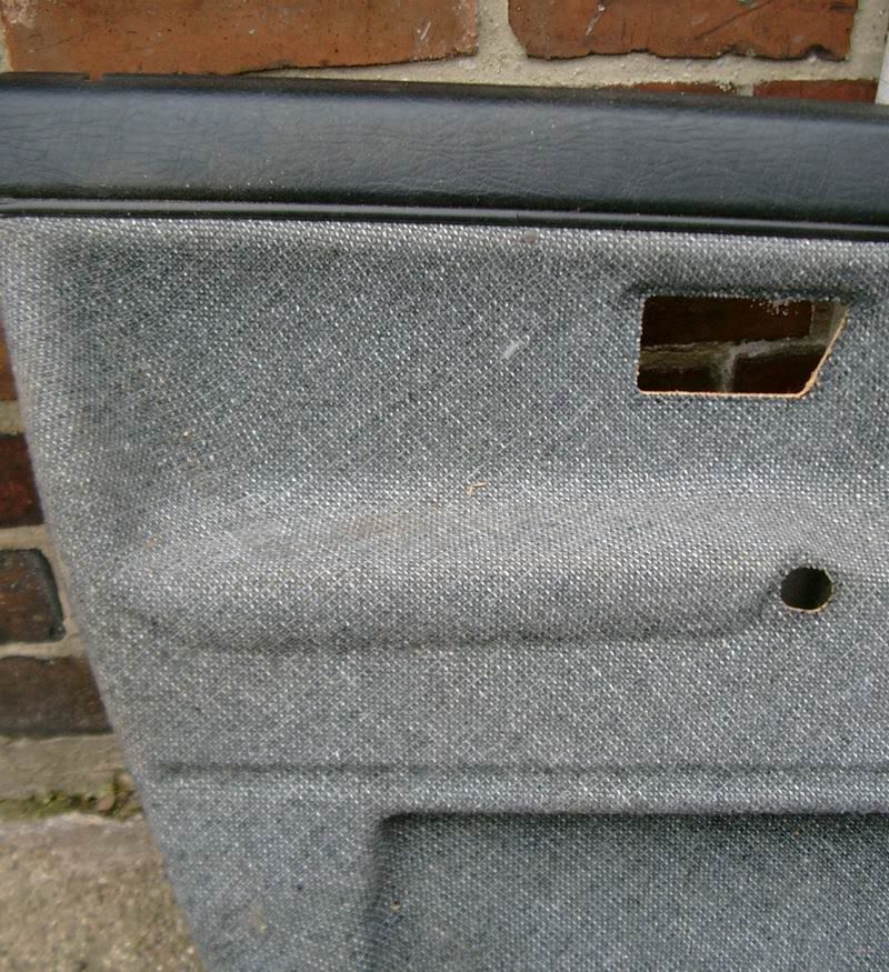

It was converted by GTI Eng 10 days before the registration date. When I bought it, it had covered 100k and was almost standard apart from a set of multi-spoke alloys and 16v rear clusters. It was still running on the original re-jetted Pierburg 2E2 carb. It was in reasonable condition and was fitted with the Syncro CL Sports interior.

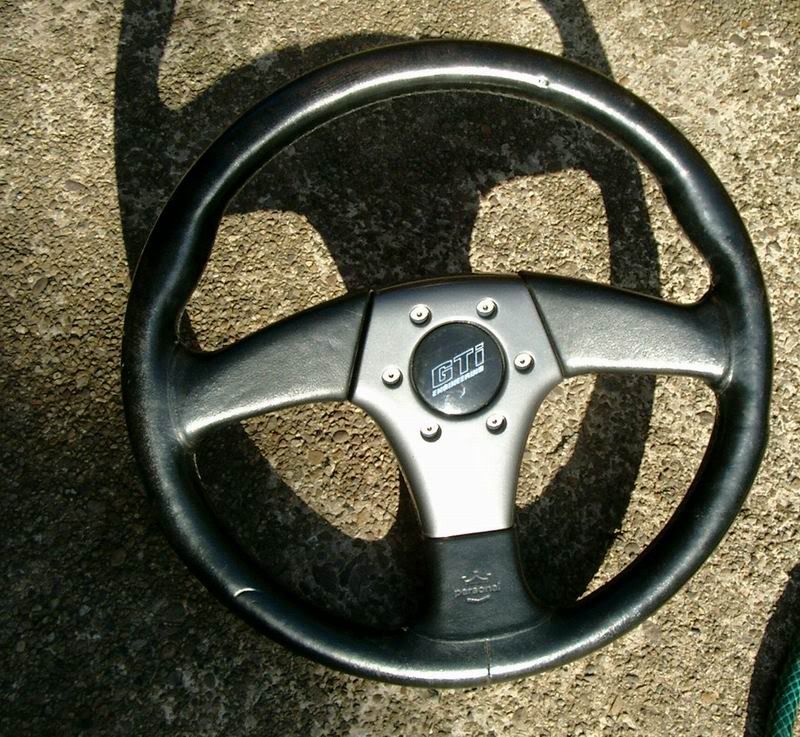

It is keeping the original interior along with a few touches and a late GTI Eng steering wheel that came from a Rallye. I have also pinched the anti-roll bars, exhaust manifold and downpipe. The d/p with have to be modified to fit and Ill have a custom stainless exhaust system. I have fitted FK Konigsport suspension. Im awaiting a Powerflex bush kit, except for the trailing arm bushes. Im fitting a set of eccentric bushes instead. The front brakes have been uprated to 16v spec with a Goodridge brake lead set. The fuel system has also been upgraded with pump and filter/regulater. I am also waiting for a full Missinglinkz tramsmission set and MJ Interiors to do a couple of jobs. There is also a set of VDOs fitted. It was painted up at Volkskraft. Also fitting a Chromalux rear screen

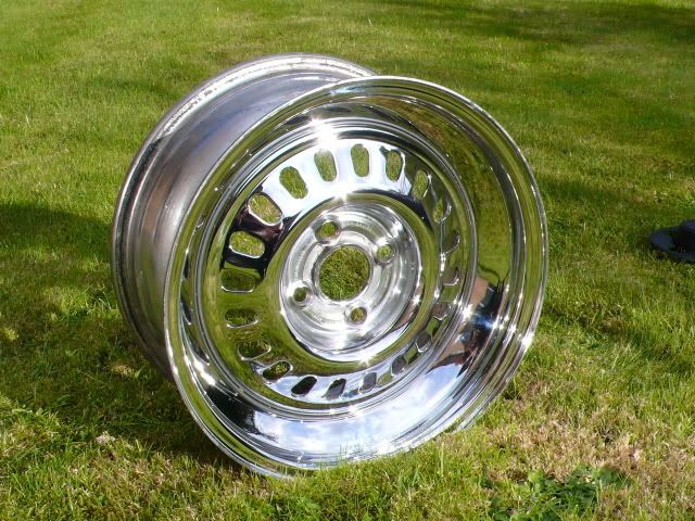

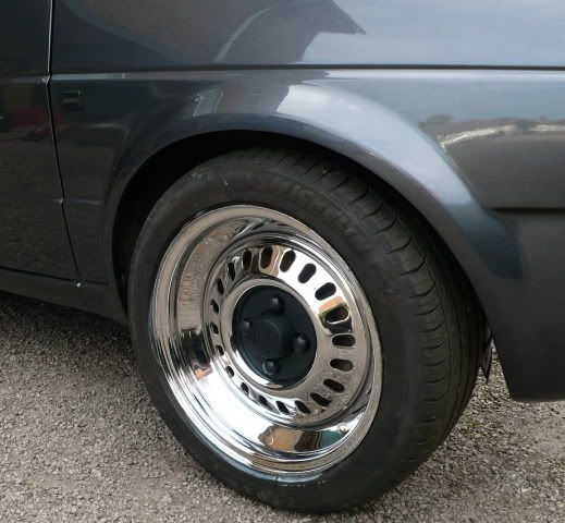

Wheels
old wheels were ATS motorsport 6x15
new wheels are VW Calmaster from a Golf Country Chrome

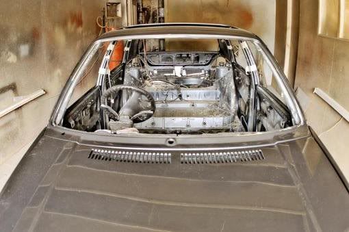

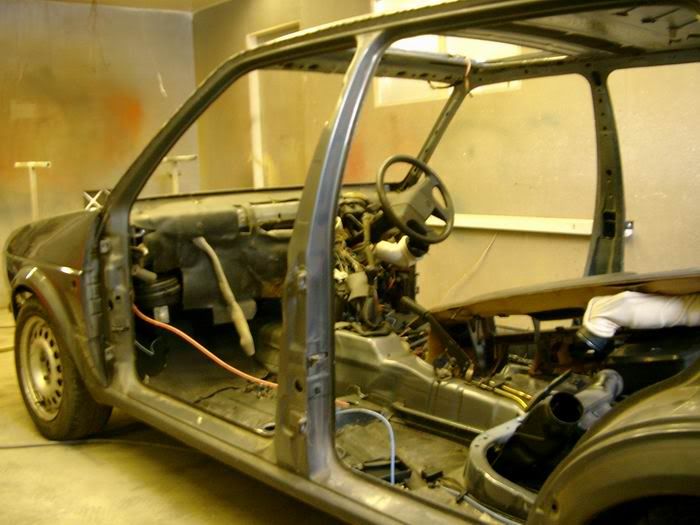

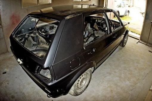

Paint prep and final finish

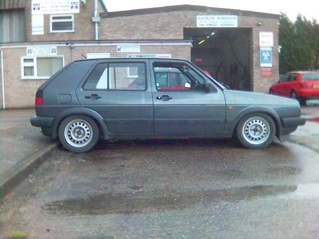

Final ride height
A few bits and pieces
Ive had this car since sometine in 2001. Ive spent all I can when I can and only driven it for 2 months when I first bought it

Heres some better wheels pics
I originally had next to no money when i started out, so using VAG parts was the way i went. That has just turned into making VAG a bit better whilst still trying to keep it factory. Many of my custom parts were made years ago, but the wheels are the best parts ive bought in ages.

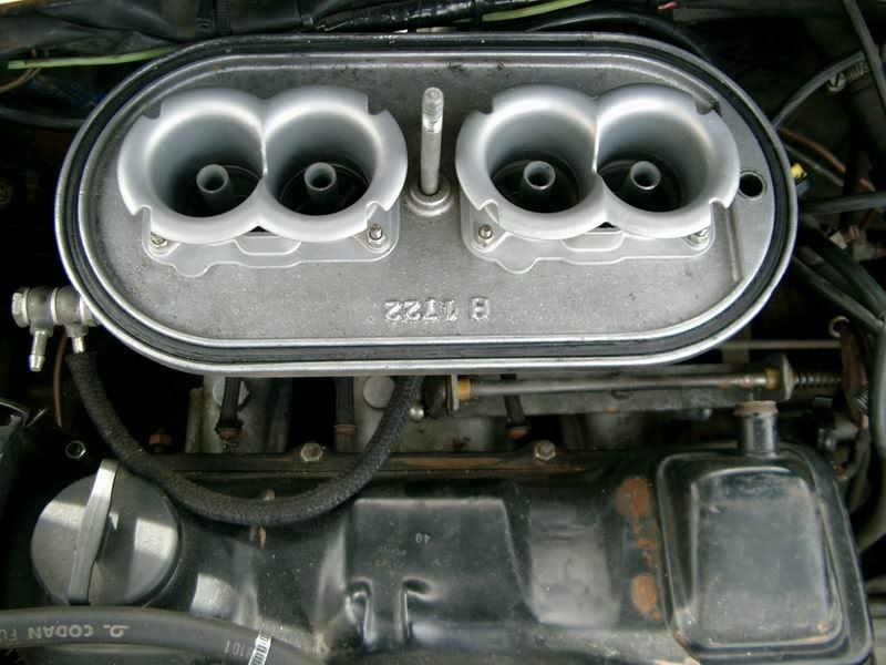

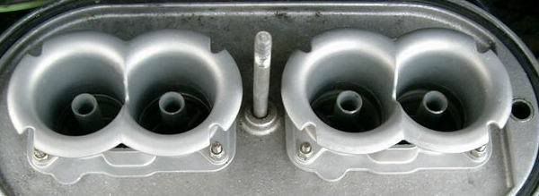

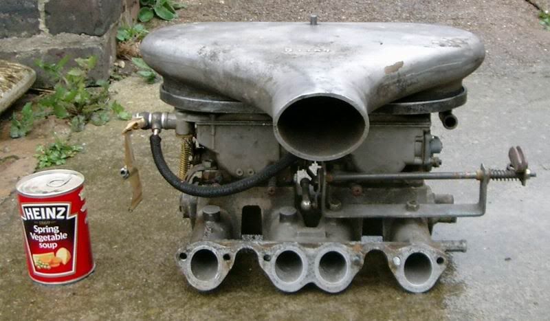

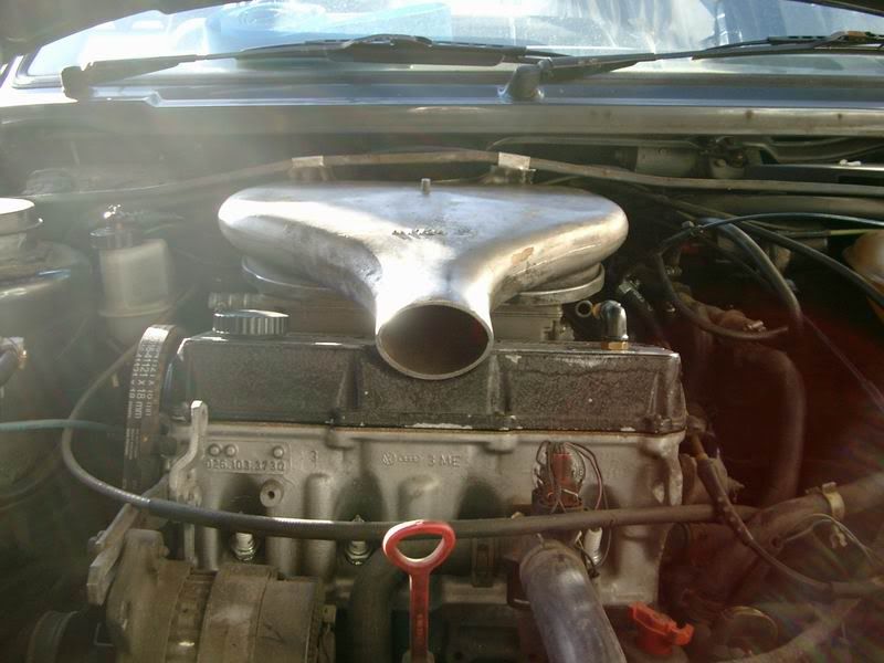

Twin carb teaser
These are DCNF downdraft carbs and its all proper kit engineered for the Mk1 and Mk2
the UK syncro was available mainly as a carb'ed 1.8 using the pierburg 2e2 carb as usually fitted to the 1.6 and 1.8 golfs etc. There was an option of injection, but ive yet to hear of a UK inj car. The German/Euro cars were carbed as well as inj depending on the spec ie C CL or GT. Do not get this car confused with the G60 engined cars. his is twin carb'ed as I want more performance and the downdraft is the only way to go with the configuration of the head. Side draft carbs suffer greatly from overheating and predominantly air starvation due to the proximity of the bulkhead
this car was modified weeks before it was even registered. The Pierburg carb  was a pathetic excuse for a carb. P*ss-ant little thing!

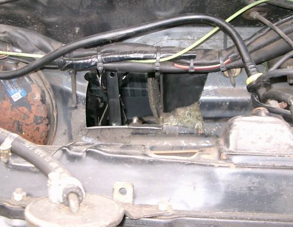

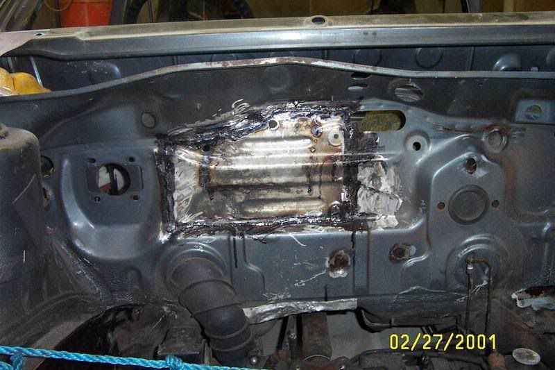

Heres the single DCOE attempt, but i decided against this due to the bulkhead mods needed. I had already ceramic coated the exhaust manifold
I started out by going the single carb route by using a Weber DCOE on a Lynx manifold. The manifold was flowed to accomadate the different inlet lengths. After trail fitting to see how things would go (ie the dirty great bulkhead hole) i decided that the twin downdrafts were the way to go> i already knew of them but they are a hard thing to get hold of. It finally took over 2 years to get the secondary airbox (that replaces the standard GTI airbox) and the alloy cam cover with the necessary cutout. The carbs are a German motorsport company item, but the best thing to replace the little girly standard carb

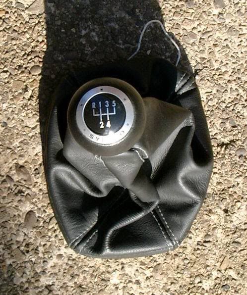

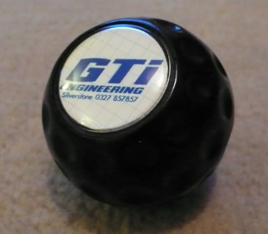

one small detail I cant decide on is which gearstick knob to use
This came from a late 90's syncro van and has syncro written on it
and this one I made years ago from a modded standard knob using a scanned 20 yr old sticker I got in one of my brochures

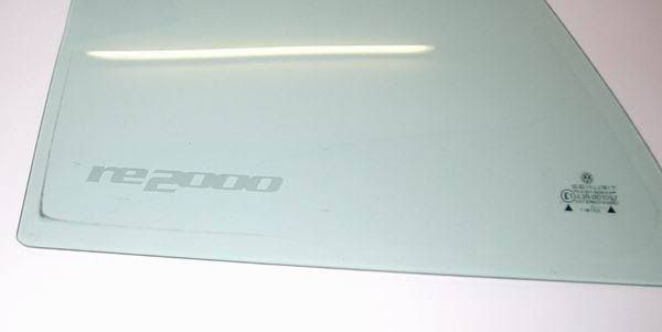

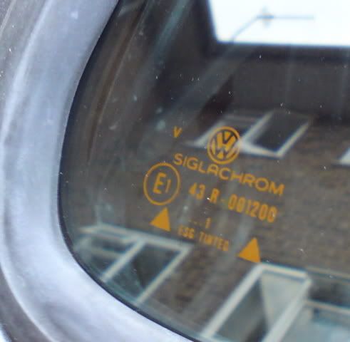

Heres the best pic i could find to show the Edition 1 siglachrom rear glass. Its more tinted than usual and has a gold flip in the sun
a couple more pics of the carb set-up

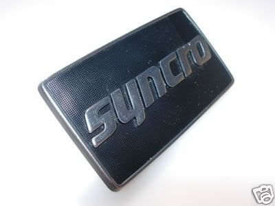

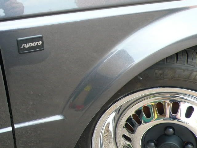

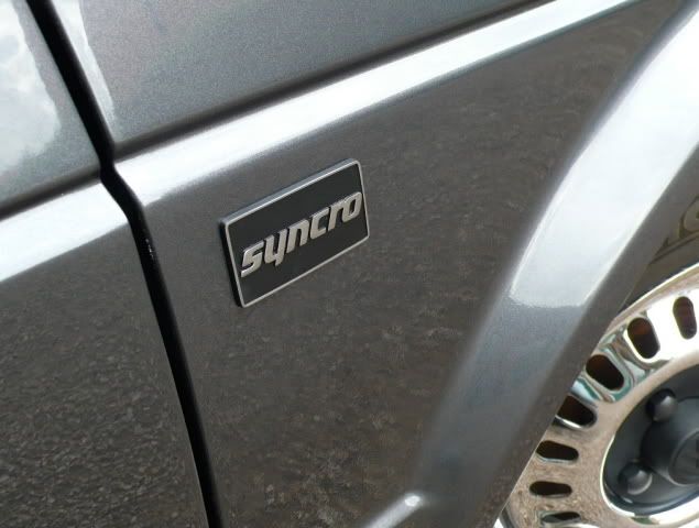

after many years of looking and favours asked in foriegn places- I now have a pair of these super-rare obsolete G60 Syncro wing badges! Only taken me 5 or 6 years to get them!
well after years and years of searching i finally have the wing badges fitted today and they look f'ing top!
however......
I then get told that the guy I bought these off has the early pre '87 badges too! Now i never even knew these existed, so temptation struck and Ive spent more $ on badges!
This has a chrome surround and also has an etched background like the
dash badge below
Im going for the pre '87 look anyway as I have a grill badge like this but
with a chrome surround grill

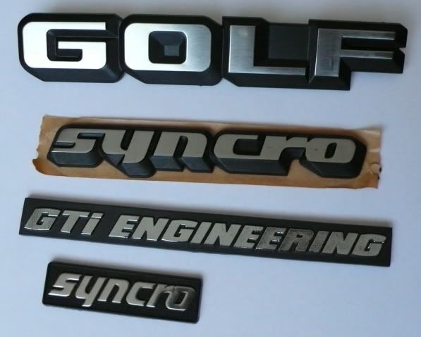

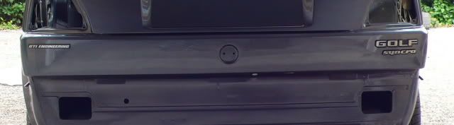

Here are the rest of the badges to match with a GTI Engineering badge too
(took me ages to find this and then a box load have been sold on Ebay!) The
Golf badge was also hard to find new. I plan to fit the Golf and Syncro badge
 as they are suppossed to be on the right side, and as I have a later rear end
with the VW roundal in the middle, Im going to fit the GTI Engineering badge
where the Volkswagen badge would have been on the early rear end.
As you can see there is differnces with the script of the Golf G60 Syncro badge
that dont match up with the old fashioned script (2 scripts were used on the
Mk2 Golf Syncro)
but I just dont know if the chrome surround badge will stick out from the
 paintwork more than I wanyt it to. Ill find out soon, but I do rather like the
old fashioned badges!

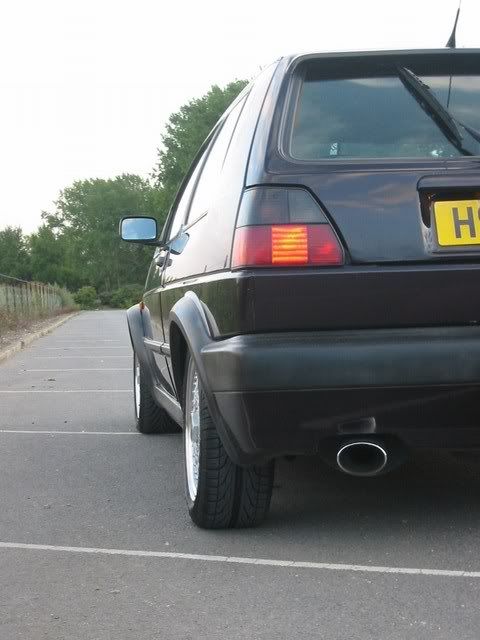

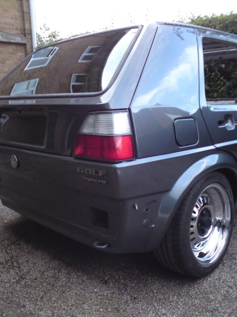

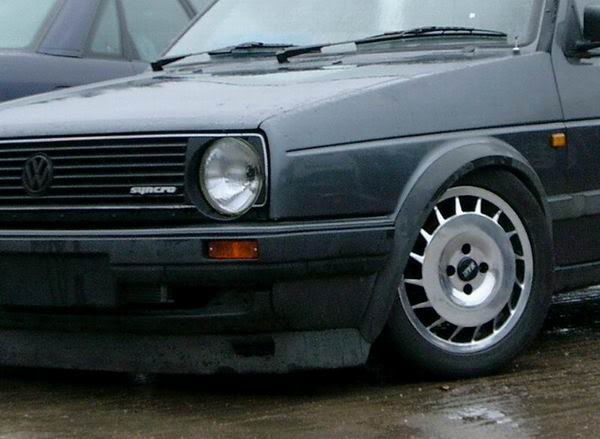

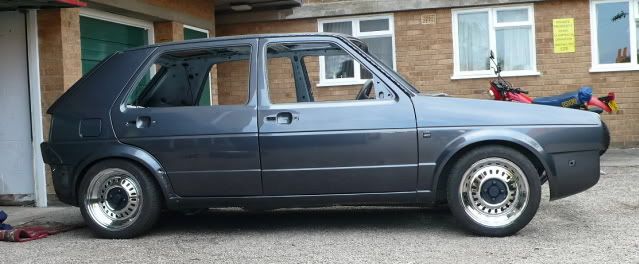

ive been playing today and fitted a couple of the wheels- only a couple you say! What a lazy git! Well, its been a mixed bag today. Firstly the wheels look soooooooooooo bloomin good, but the front wheels catch the brake caliper  :banghead:
I need to buy some slimline calipers to make the clearance. I cant put spacers on as the wheels are ET28 and already dangerously close to my standard arch's. Im aso going to have a think about tyre sizes later too. Im using 195/50/15 as thats what I already had from previous alloys. Although Im thinking about 185/45/15.
I also added the badges to the rear of the car.
I received the earlier syncro wing badges today and as soon as I opened the box, I knew they were larger than the G60 ones! I really ddidnt know what to do. I put one on the car and walked from side to side, but I was still unsure. So I went and had a cup of tea
When I came back, I realised that they werent really out of scale, so Ive kept them. Got some 5mm spacers so Ill get those on as soon as Ive bought a new trolley jack. Its a bugger to get wheels on when gravity and a leaky valve are doing their best to thwart you  :mad:
Its bucketing it down over here and my garage is a tad tiny so Im waiting for the inevitable 10 mins of sunshine to happen whilst Im at work

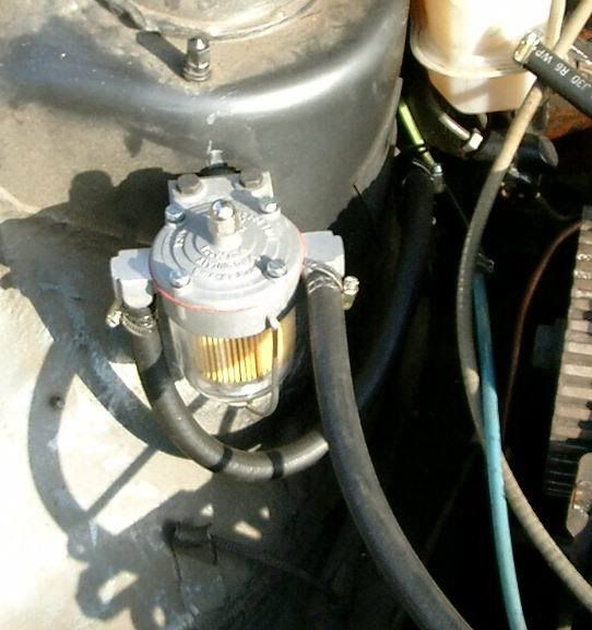

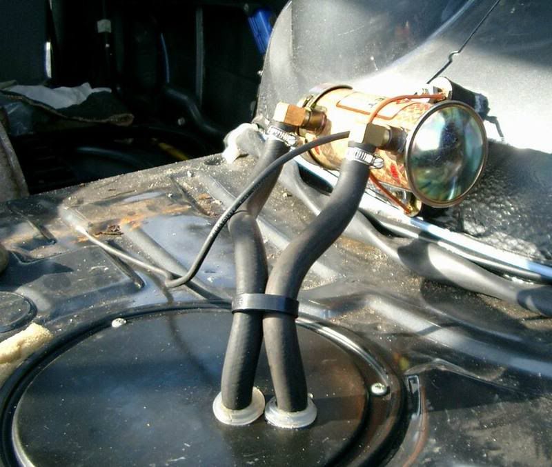

Facet red-top fuel pump mounted to the rear arch skin
Filterking fuel regulator. I chose this glass one for the retro look and I also managed to get a mini VDO fuel pressure gauge

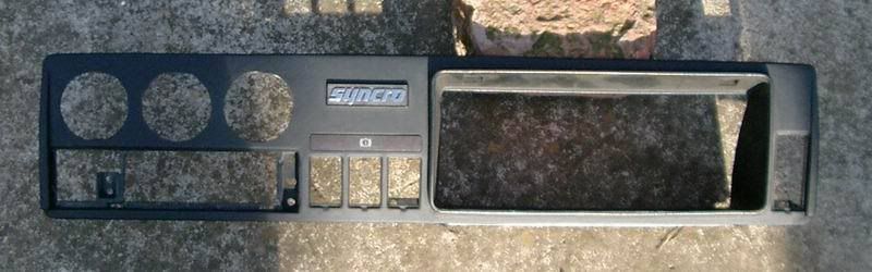

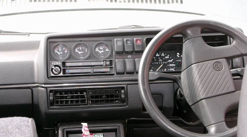

This is the remodelled dash surround i made a many years ago and then got it covered in leather. Ive relocated the Syncro badge that was originally placed on the glovebox

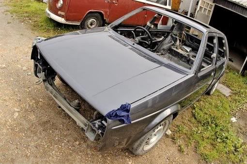

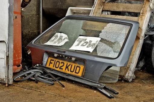

Well, Ive been busy in the loft more than on the car, and its amazing what you loose when you squirrel things away.
The rear screen isnt fitted properly at all and is only resting there. I tried to show the tint, but it just wouldnt work
