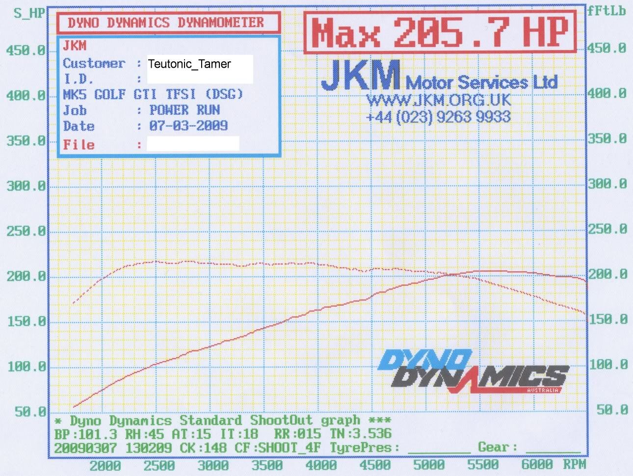

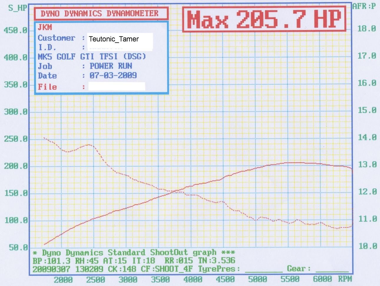

OK, post up your graphs.
Here's mine:
Any comments?
I'd like to see what differences between IATs peeps got.

Did your gti just have the uprated ICs TT?

Yup.  Well it has another few non-engine mods too - but they wont affect how many ponies are under the bonnet.  So the intercoolers give an extra 8 ponies over stock.  :cool:

Nice torque curve on yours T_T, seems that the Intercoolers help hold boost??,rather then falling away like most ive seen on jkm's rollers.

I must say it does look a rather smooth curve for both torque and power. :cool:

Thanks mate.  Yes, the uprated coolers do help at the top end - quite a lot.  It is much more apparent with the 'mk1 butt dyno'  :wink:
And it is why I tried to persuade RedRobin to go down this route when he had his turbo issues.  OK, whilst they will never make up for what a K04 can offer at top end, the uprated coolers do cancel out one of the main limitations of the K03, whilst still retaining the K03s low down bottom end.
Yeah, I was well pleased with it.  Not bad power for OEM map, particularly as Jim explained that an OEM map will always try and 'top out' at 200PS/197bhp.
