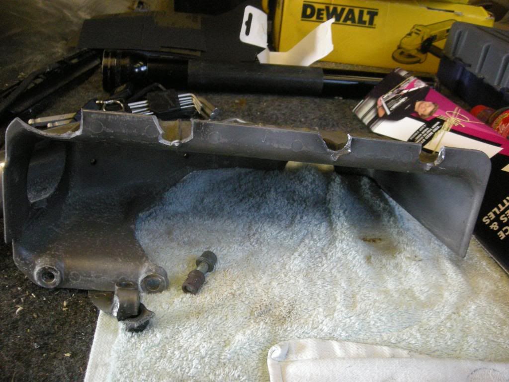

Well it becomes obvious what the problem is as soon as I get the first (hex head 6mm) bolt out!

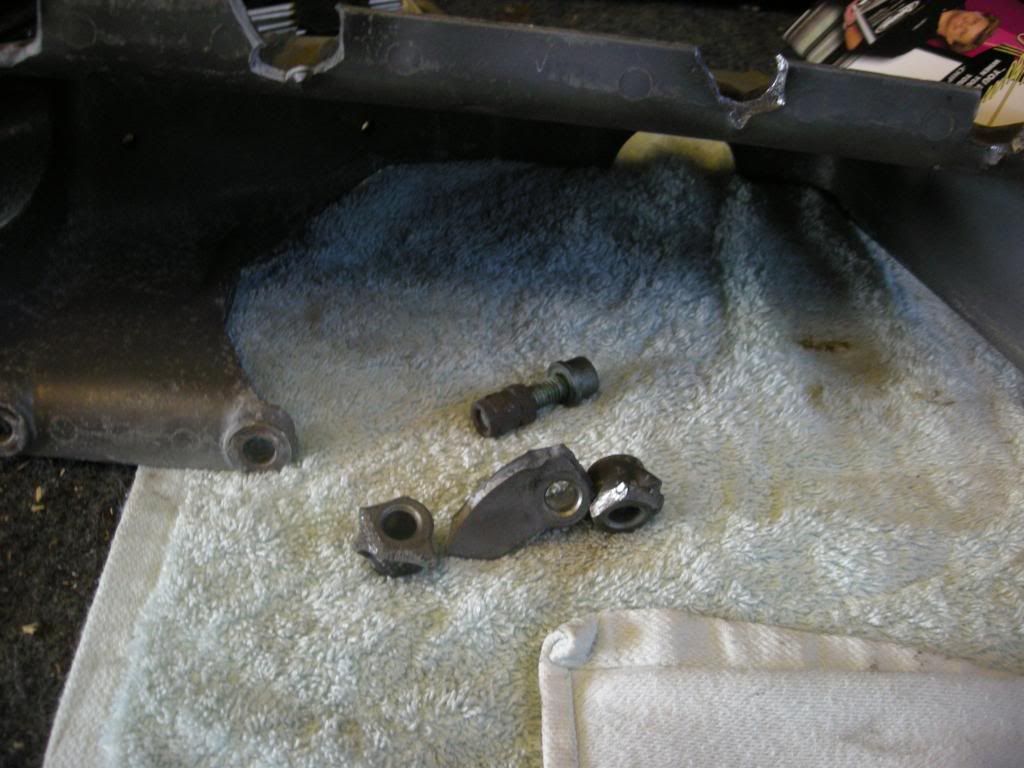

The ally shield is broke around the bolts! All four top bolts!
I then find there are 2 more nuts on studs under the heatshield (12mm) and eventually get those undone and can lift the great lump out!
Pics to follow!

Pics of alloy heatshield.
This view shows the absent bits!
Here are 3 of the 4 bolt hole pieces. (lost other)

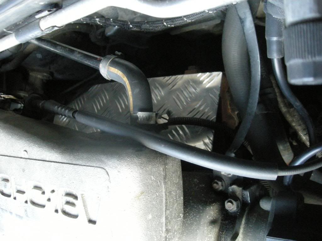

So for a temporary solution after checking with mate if he can ally weld? (NO!)
Ask him if he's got any metal plate? Yes a piece of ally chequer plate!
So he brings it down to me and I cut it to length and then bend an angle on it and drill 4 holes in correct position!
Best photo I can get of it fitted.
So that will do for now until I can source a good part from scrappy.
And guess what?
No buzz! No Rattle, No Hum!!! Bloody silence!

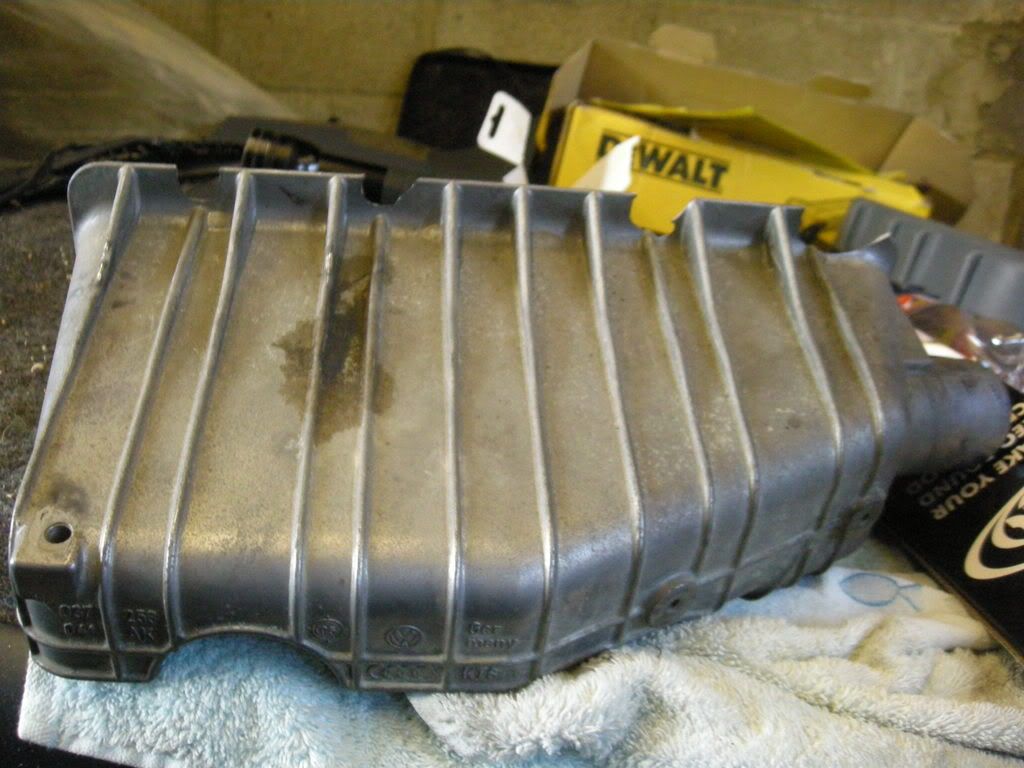

Well I took a trip to a local stealers this lunchtime for some spray paint and thought I would ask whilst there for a price on a new heatshiled!
Well I was surprised! £39 inc VAT!
So I ordered one!
Gonna take 7-10 days but thats cool.

Maybe but it doesnt give same coverage and the warm air feed to filter!
