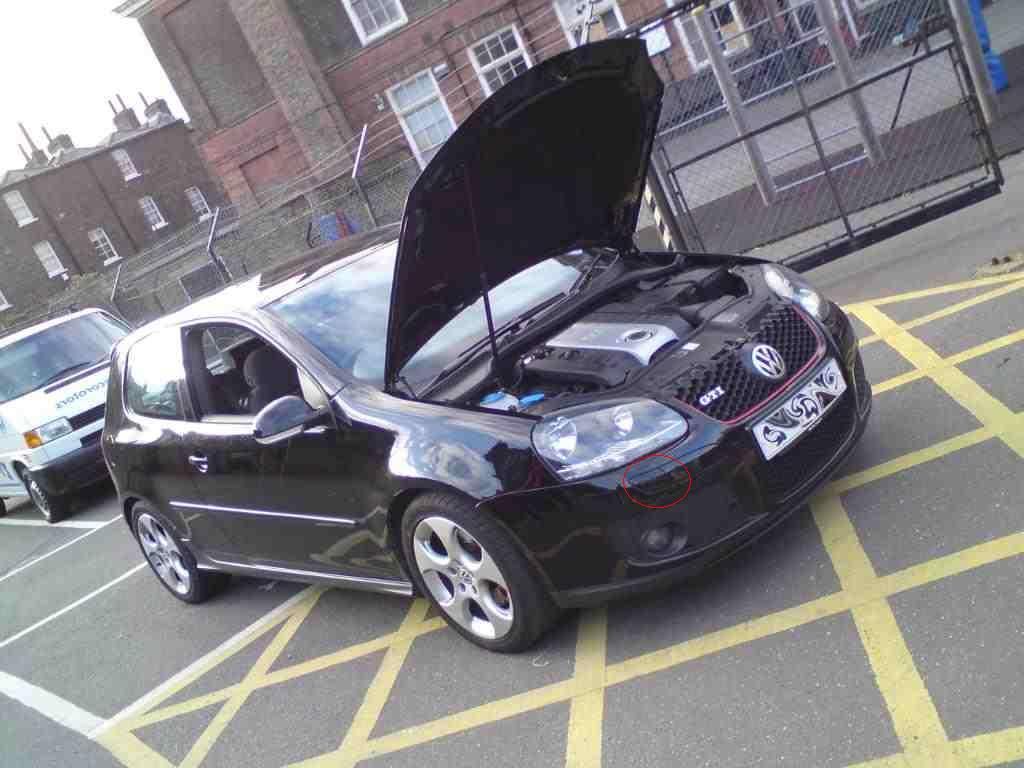

 forgive the daft question, but how do you know if your car has this function ?  :rolleyes:
Offline AlanD
  • Posts: 9,946
  • MK5 2.0T 16v
Re: Headlight Washers stopped working
« Reply #21 on: 20 January 2009, 12:33 »
You should have a litte rectangle thing under your headlights.
Its quite hard to make out but you see the line / gap going though it? Thats where it comes out and sprays the headlights. If you dont have them then you wont have that line / gap.
