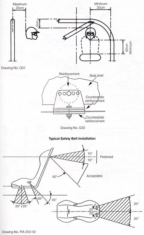

diamond hell are you moaning about harnesses again?
fia drawing showing mounting angles:
if the 2" harnesses weren't safe they also wouldn't be fia approved.

There's a huge difference between approved harnesses and approved mounting. Also those harnesses aren't even approaching the minimum 45 degrees on that pic. The issue isn't FIA regulations, the issue is physics and what a serious amount of downward pressure on your back can do.
