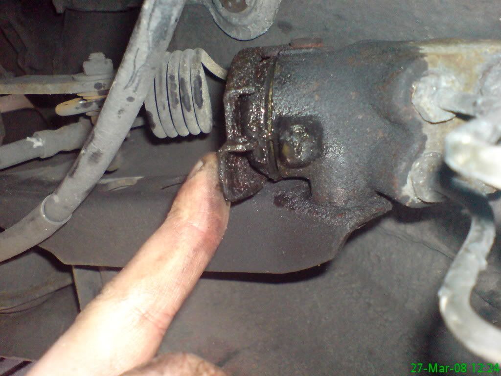

when i had my MOT done i had an advisory saying my brake load sensing valve linkage was seized. Im having a day today tampering with my golf and have had a look at it. i dont really know what exactly im suppossed to be looking at though, but here are some pics
apart from the slight leak im not sure whats supposed to be seized?
also it looks like something is prehaps missing from where my finger is pushing in the top picture? am i right or wrong?
any pointers/ advice/ critism or abuse would be helpful.
cheers J

Aha, that's the bias valve. The arm connetced to the spring will pivot on a pin pulled by the spring, but will be rusted up. Soak in your favourite lubricant to free it up or replace (about 40 new i think).

does everything look as it should to you? it seems like something is missing?

Looks alright from this angle. If i remember rightly there's a rubber bit the spring attaches to on the arm. Don't think the bit you were pointing to matters really, more the side you can't see in the pic.

the arm seizes up so it wont move when more weight is put in the car. so it got to be free and working
