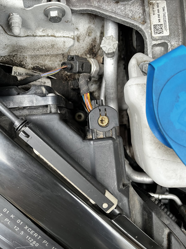

Does anybody know if this allen bolt (left of the coloured wires) is the one you turn to tweak the height of the main beam?

I think the one you've pictured adjusts the left/right of the headlights though as it can be done using a phillips or a hex key - I seem to remember the height could only be done with a hex key because I had to buy one to adjust the height previously...

Left is the up down (it shows you the direction to turn on the housing), the one on the right is left right. You don't need to do anything with VCDS when adjusting as that only effects the self levelling when you lower the car and nothing to do with height adjustment.

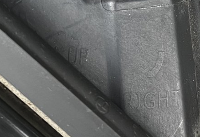

Oh yeah, I didn't notice that text until I zoomed into the photo I took. Just to confirm, the UP-DOWN is an allen key and the LEFT-RIGHT is a Philips screw, by the looks of it.
