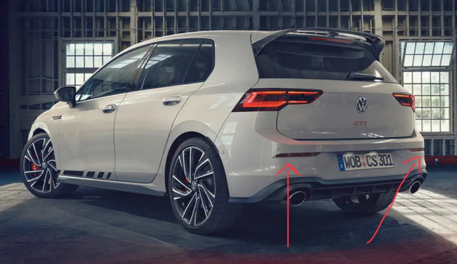

Does anyone know where the sensor is for the blindspot monitoring light in the mirrors?

Assuming the location of the sensors (there are two of them) on the mk8 Golf is the same as on other VW’s that have blind spot monitoring, then they’re located on the rear corners of the car behind the rear bumper cover; roughly in the locations marked on the picture below;

Thank you sir!
