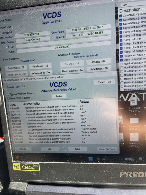

Thanks Joe6. Managed to find the value with your help. As it’s a EA888 Gen 3 I’m not sure how relevant the numbers are given all the guides and posts I can find on the subject are for pre MQB cars.
Here’s what I found anyway.
Camshaft intake phase position -0.3 deg
Will report back if the fault comes back. Hoping it was just a duff sensor, will get the timing checked anyway in a couple of week for piece of mind. When buying used cars you never really know the history / reason for sale..

Early Mk6 had chain and tensioner problems, hence the obsession with phase values. -0.3 sounds a good value.
