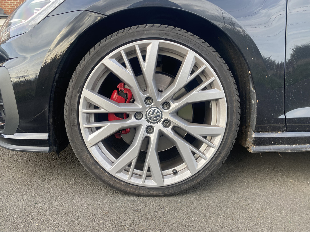

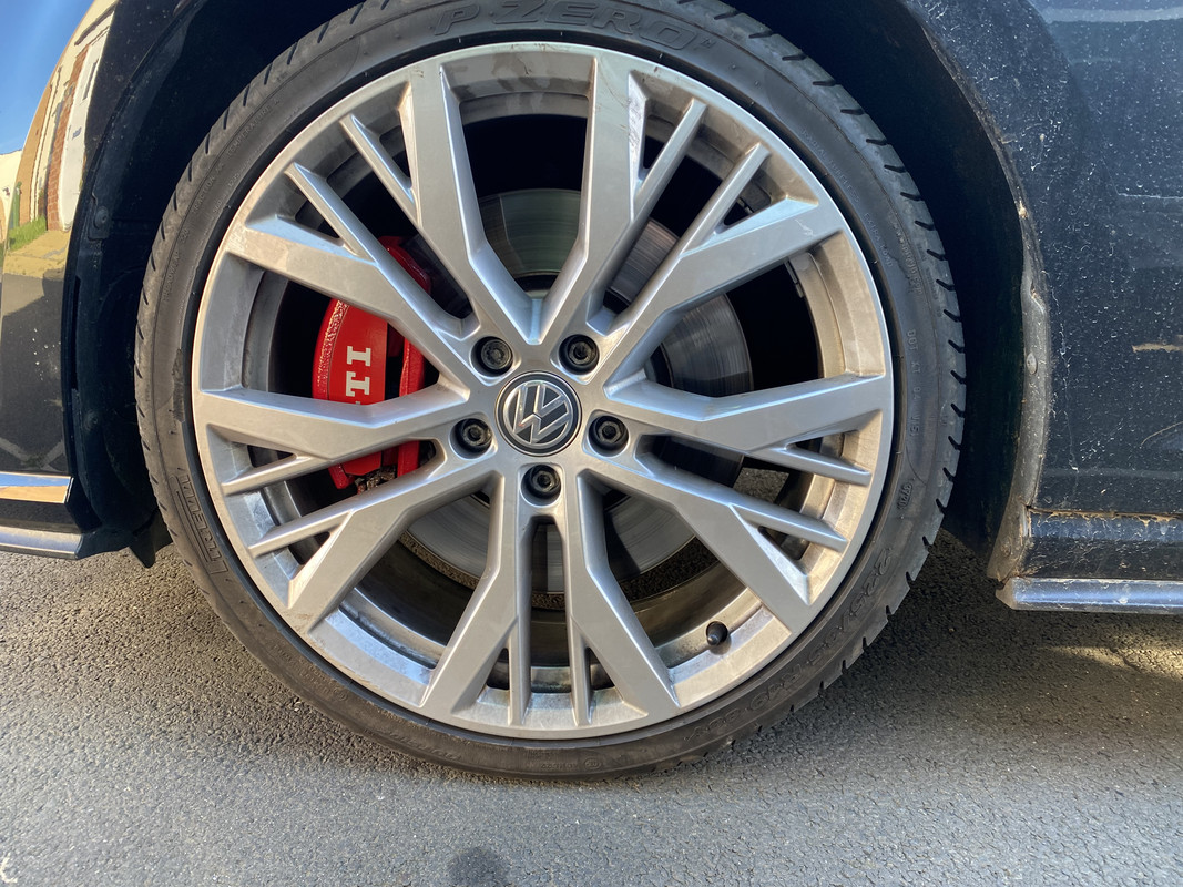

« Reply #19 on: 26 October 2022, 17:39 »
Hi all,
Just want to say a thank you to everyone who posted and assisted, got my PP brakes installed today. Cost me about £400 in total including the install and a brake fluid replacement with ATE race fluid. (Changes included new Oem brake shields new calliper bolts, new sets of oem pads, Oem discs were included in the calliper purchase price of £250, new decals for the cover plate.
Happy with that for now. Will probably move to a clubsport disc and Ebc red pads after the winter. Just to spread the cost out a little. Quick after and before but i am sure you all know what they look like.
