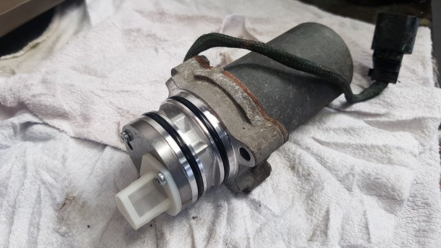

Make sure whoever does it removes the pump and cleans the screen filter (white piece in the pic)
When I did mine, which was long overdue, the filter was clean, but it's worth doing anyway for peace of mind.

Ive serviced my own Clubsport VAQ diff and a friends Golf R Haldex and didnt replace the "O" rings on the pumps on either, and neither have leaked from the pumps.
I think the "O" rings for the pump are £20 odd from TPS.
Got the fluid from here - https://www.ebay.co.uk/itm/255527403203?hash=item3b7e9ebec3:g:JgoAAOSwHmJfAYnw
A pump relearn is not strictly required but recommended if you clean the filter.
